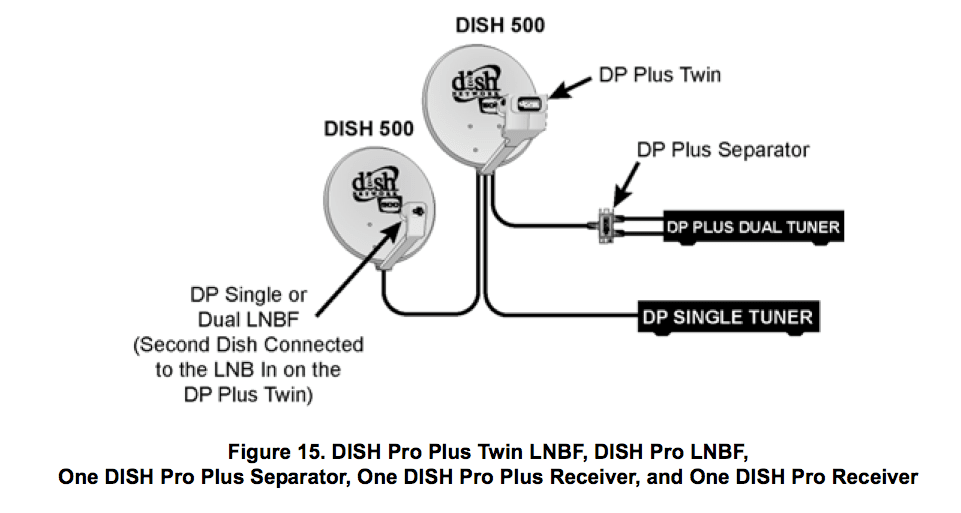

Okay, here is a pic of what it looks like. (Credit scottc98 for the graphics)

So I just need a separator and another receiver and I am good to go. Just like below.

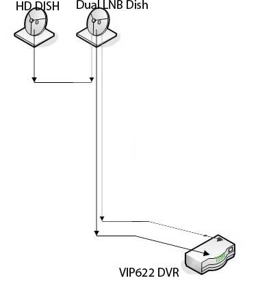

Or I could install another dish on its own, as mentioned above. - A lot of options.
