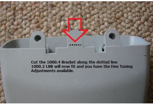

The 1000.4 has built-in fine tuning for both azimuth and elevation. For portable use, I modified mine to make the setup and adjustments completely tools free.
If you have 1000.2 LNB locate a 1000.4 dish setup & LNB Bracket. Remove the center tab and the 1000.2 will fit.
I do this on systems where I cannot use the 1000.4 and I need fine tuning. Works.
