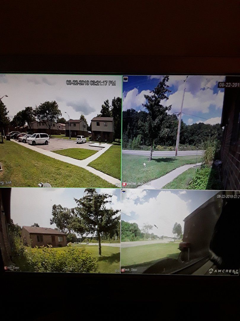

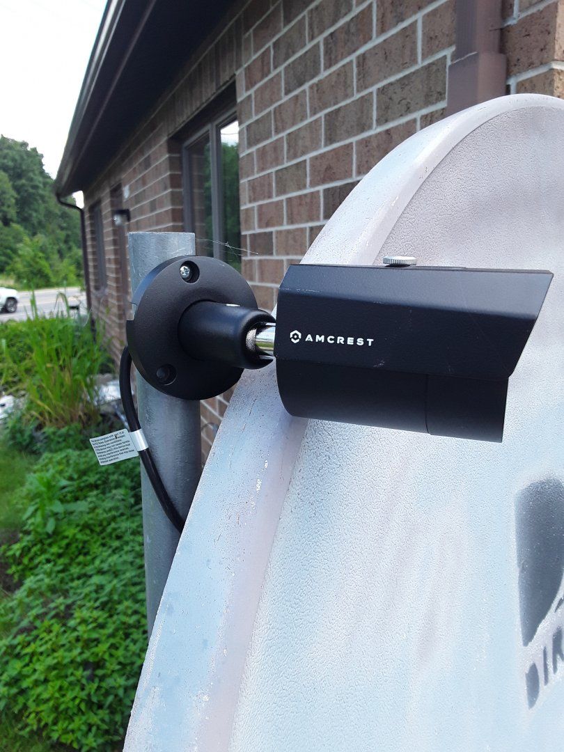

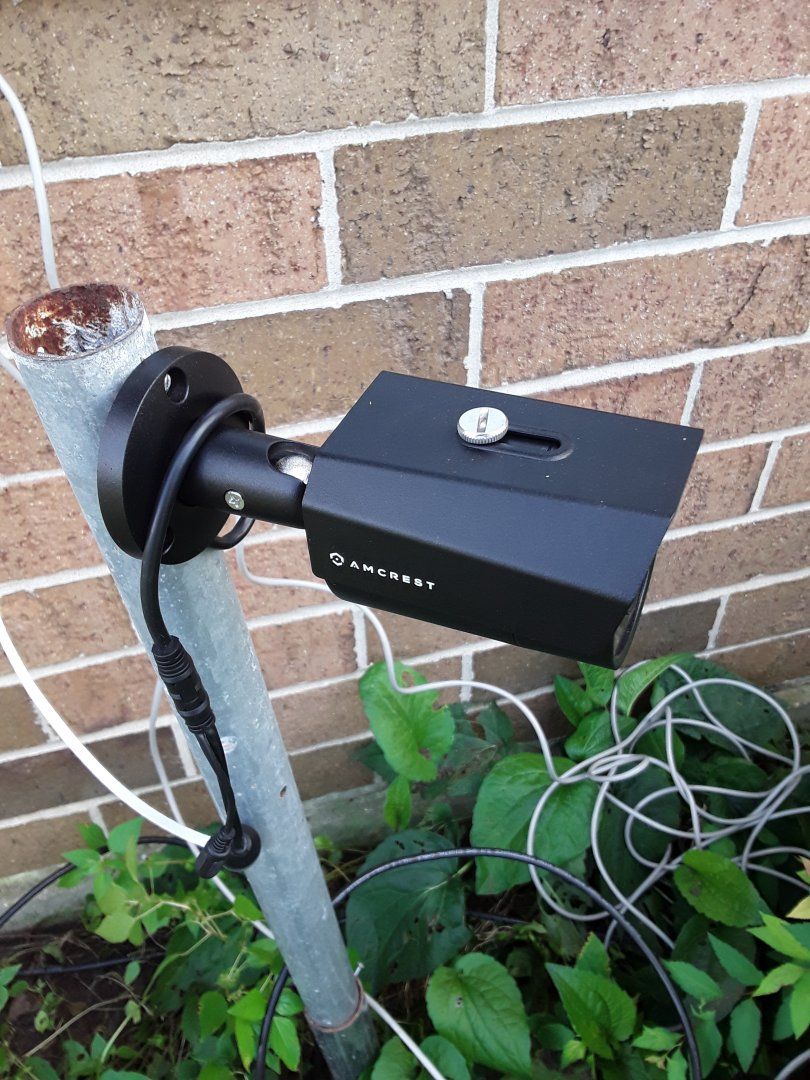

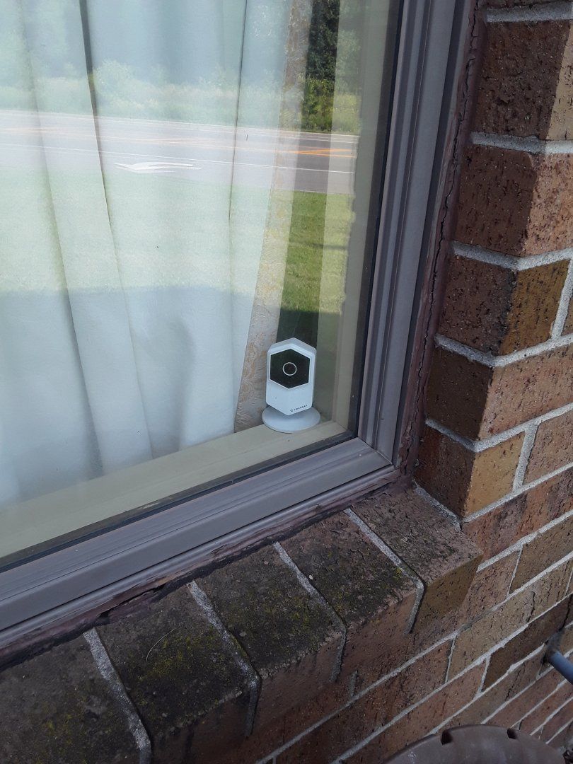

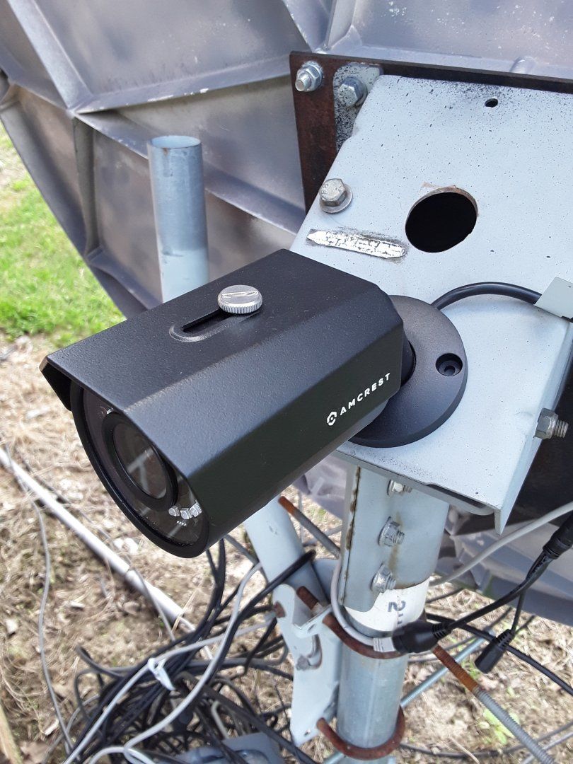

I have upgraded my nvr to an Amcrest nvr. I have 3 1080p cams and 1 2k camera for the back door. This is a POE system. Here are some pics.

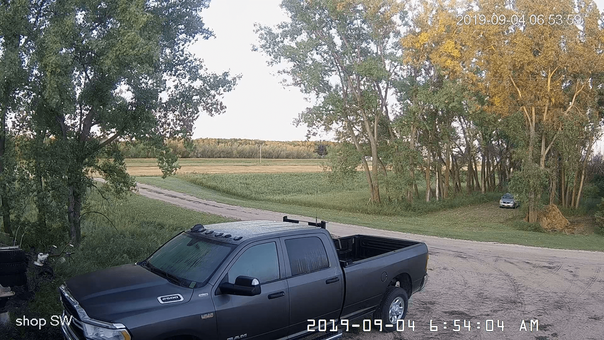

Mine are all set for 15fps. Either H265 or H264 depending on camera age/firmware. Mostly use cat6e stp cable to minimize voltage drop (23ga as opposed to 24), not much run exposed. Ubiquiti A/P at the house and 2 remote sites with small POE switches to power the cams, and some underground cable runs for distribution.
This is a shot from one of the cams with a variable zoom, zoomed all the way out. Catches traffic coming in/out of one of the driveways.
