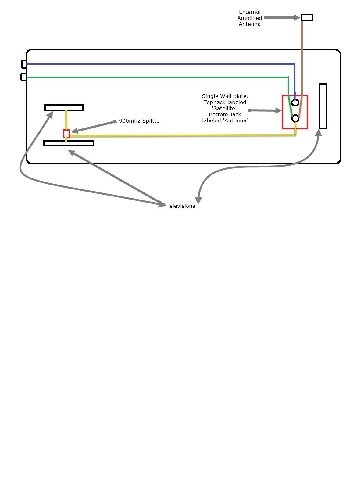

Here is a quick diagram showing how the camper came wired from the 'factory.'
Will try to explain that diagram here. lol The back of the camper has two jacks. One that is not labeled, and one that is labeled 'satellite prep.'
The Satellite Prep jack on the back of the camper is directly wired to the top jack on the wall plate by the primary TV. This specific jack on the wall plate says 'Satellite.'
The input in the back of the camper that is not labeled at all is wired directly to the bottom jack on the wall plate by the primary TV... this bottom Jack is basically the 'amplifier' for the external over-the-air antenna. This jack/'amplifier' has power wires, coax from the rear non-labeled input, coax from the antenna, and coax that feeds the rear two Tv's.
In stock form, if you want to watch amplified OTA signal, you simply hook a coax cable from the bottom jack on the wall plate and plug it into the main TV. The other two TV's (towards the rear of the camper) are both fed from the back side of the wall plate which is located near the primary TV... this coax is hooked to a splitter (900 mhz) in the wall between the two rear TV's. Simply turn on the switch for the amp, and all TV's get amplified OTA signal. Easy.
