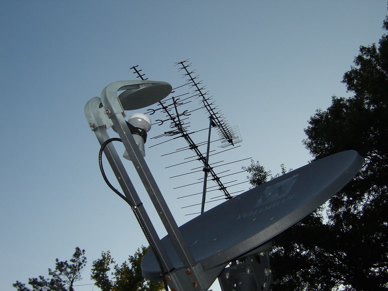

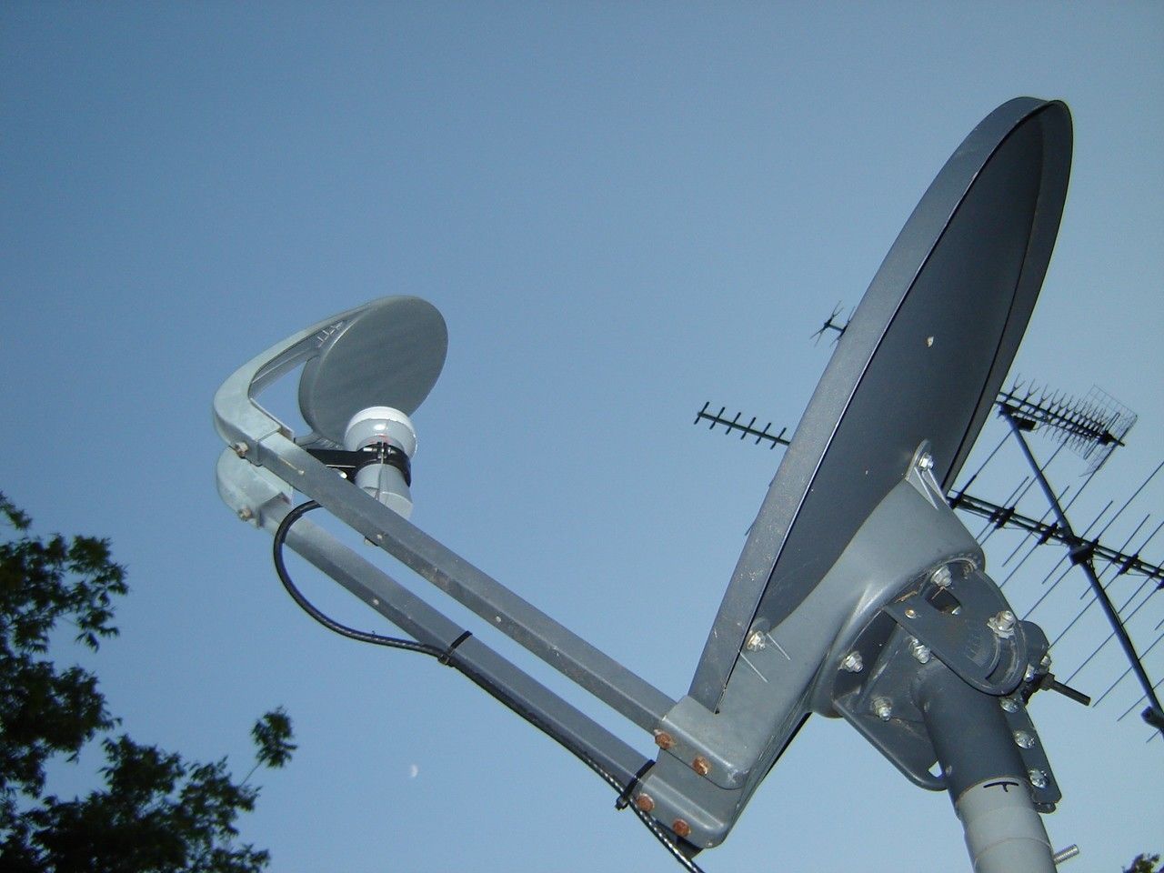

I tried extending the focal point on this Wildblue dish by building a bracket about 5" longer than the dual support arms and mounting the lnb there, but it seems to get better gain using the 2nd reflector. On 97W, I'm getting low 70's Q using this Tracker II lnb.
I'm sure that a Spitfire would improve the signal. This dish was nearly useless during any rain event when it was used for internet.
