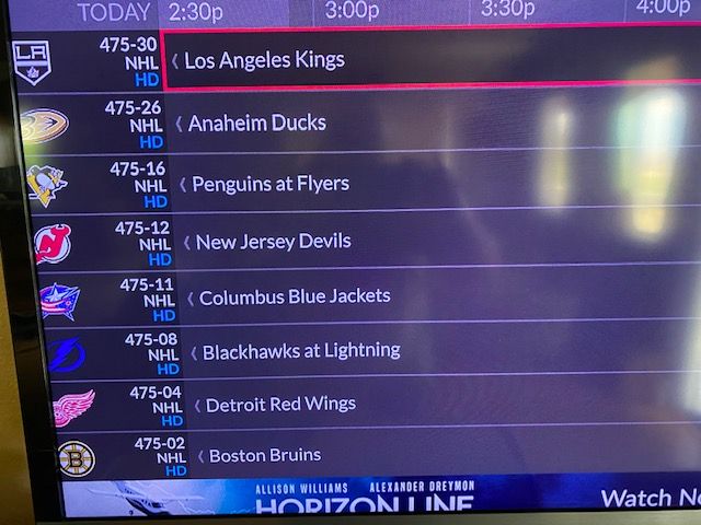

In my original post, I stated that here in Hawaii (and I'd imagine Alaska also) we're receiving 9 NHL Center Ice channels. However, it seems that DISH can reassign them at will.
Yesterday, one of the 9 we received was 475-07. Today, that has been replaced with 475-08.
What I can't understand is - if this reassignment is possible, why is DISH giving us 7 of the 9 channels that have no games being played. They're just blank. Plus, Kings & Ducks will always be blacked here.

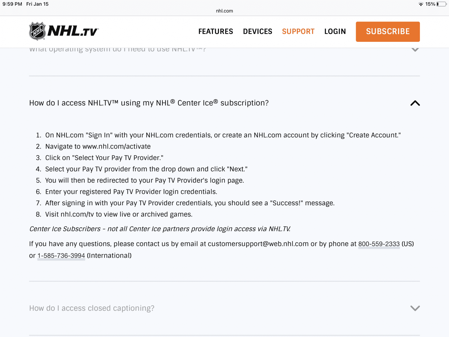

Edit: I just reread your second last post and you already knew about NHL.TV. Ill leave this up for others. I can understand why you want to DVR the games given the six hour time difference.
Your NHLCI subscription also comes with a subscription to NHL.TV. If you can't figure out the issue with your Hopper and have a good internet connection you could at least watch your games on a tablet, fire stick, rogue, etc. Use the instructions below to link your account.
What I can't understand is - if this reassignment is possible, why is DISH giving us 7 of the 9 channels that have no games being played. They're just blank. Plus, Kings & Ducks will always be blacked here.View attachment 149859
Dish does reassign them at will, pretty much on a daily basis, but it is not for the purposes of optimizing the package for Hawaii. Dish shuffles the channels around to different transponders (and often to different satellites) in order to balance the load, so to speak. In other words, they can cram a bunch of channels that are not actually being used onto one transponder, while spreading out the ones that actually have games over several other transponders. The problem is that you are not receiving any of the NHL Center Ice channels from the 129 satellite. So, you would only see the ones that happen to be on the 110 satellite and/or the ones on the 119 satellite that day. From today's uplink report, here is the change that you noticed:
