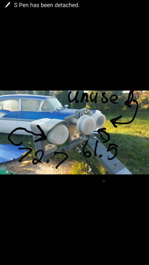

To save the hastle of flipping arc I've heard a dish 500 could be used for 61.5 and 72. How would a 105 superdish work since the reflector is bigger. I moved the 119 sidecar lnb all the way out to make it close as possible. Ill try a meter on it later today.
