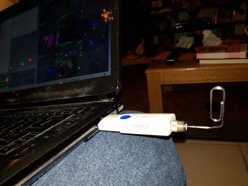

Let's address the antenna. The antenna measurements commonly cited are for optimal reception. For a UHF station, antennas don't need to be so large, as the wavelength of the signal is quite small. For a VHF-hi station, a dipole antenna needs to be anywhere from 26.4" for RF ch 13 to 31.8" for RF ch 7. For VHF-lo, the dipole needs to be quite long - from 66" for RF ch 6 to 98.6" for RF ch 2. The truth is, you didn't need an antenna that large for decent reception in NTSC analog and you don't need an antenna that large for ATSC 1.0 8-VSB modulation. Unfortunately, I don't have any VHF-lo stations in my area, but it's been a common saying that if your signal is strong enough, you could pick it up with a paper clip. Certainly, that is not the optimal antenna, but I did a little experiment. I took a 6" paper clip and plugged it into my ATSC 1.0 tuner dongle (see PaperClipAntenna.jpg).

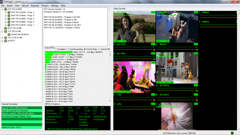

Hardly the most optimal antenna. Yet I was getting a serviceable signal on KAET RF ch 8 (see KAET.png)

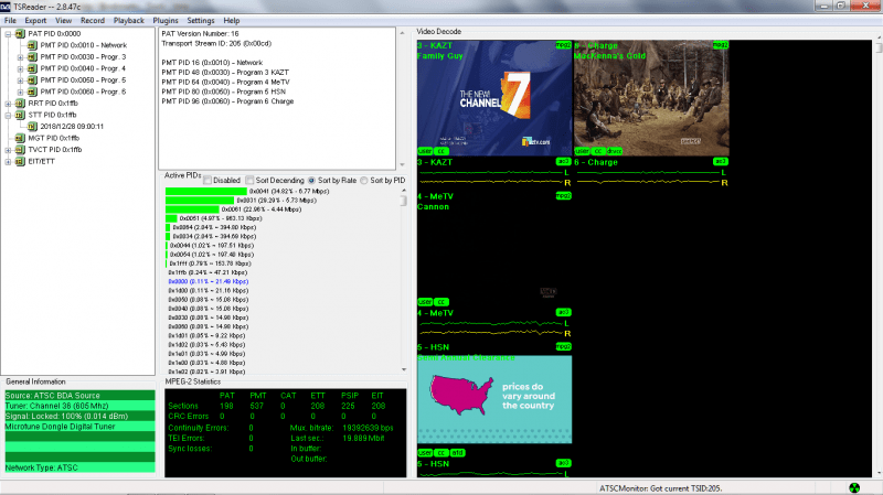

That's right, on high VHF. That wasn't supposed to happen. Here's low power Class A station KAZT on RF ch 36 (see KAZT.png).
A 6" antenna can easily be miniaturized using a fractal antenna, so it's not hard to conceptualize putting a receiver into a cell phone or tablet.

You left out a couple of key metrics in your analysis: distance from the station and barriers to propagation (or lack thereof as I suspect is the situation where you are). Most of my TV stations are about 50alm away (as are most of my FM radio stations). I happen to have LoS to most of them but anything less than a good set of rabbit ears wouldn't get me the analog stations back in the day. If the TV was moved or even turned, the rabbit ears would have to be adjusted.
I have a 60 mile antenna now and it does great but I have to point it within a few degrees of the towers or the signal is trash. I understand antenna loading and fractals, but there is a limit on how low they can practically go. I firmly believe that the whole "mobile TV" thing has been grossly oversold as it applies to viewers outside the major metropolitan areas.
I can tell you that at that distance, mobile will not be likely. I don't know where you've been reading, but I've never seen mobile sold as available from great distances. In fact, it's well-known that signal propagation is one of the areas where 8-VSB modulation outperforms OFDM, and a major reason why the FCC went with 8-VSB 20 years ago, when Sinclair was pushing for COFDM. When ATSC 3.0 becomes a reality, look for a wave of stations requesting power increases, and the FCC revisiting their power limits.
Although I have a favorable location for OTA, my readings were taken from indoors. With a stucco house, the chicken wire on the outside walls that hold the stucco in place also attenuates the signals somewhat. Mobile viewing will always be subject to those limitations, regardless of modulation. It will remain to be seen how forgiving ATSC 3.0 is; what we do know is that ATSC 1.0 is completely unforgiving. I can't imagine it getting any worse.
What I did show is that it doesn't necessarily require rabbit ears to receive hi-VHF, especially the full-power stations. And UHF should be a slam dunk. Although it was a 15 kW signal on RF ch 36, there is also a co-channel station in Tucson, 100 miles away. I can't say how lo-VHF will perform, as the closest LPTV station to me is 100 miles away in Tucson, and the closest full power station is 300 miles away in Las Vegas, and those are ATSC 1.0 stations.
