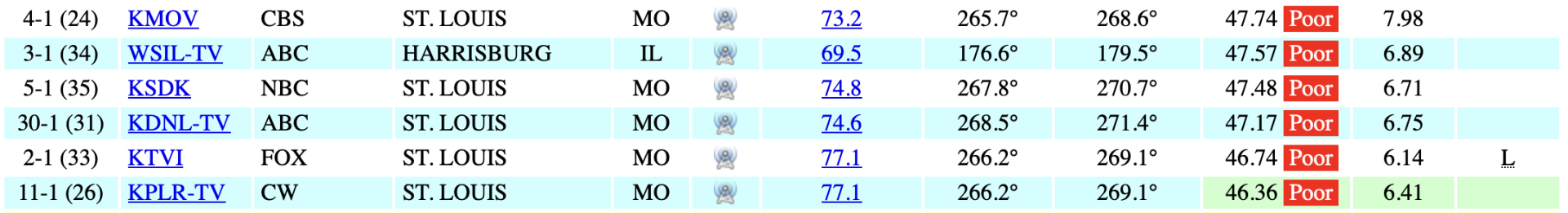

Here are the channels I would love to be able to get via OTA. All between 69.5 miles and 77.1 miles away. The height of Antenna I entered is 25 feet. All show up as poor. Is there an antenna on the planet that would pick up these stations.

Yeah that is what I figure as well but thought I would ask the experts. The only way it shows a "fair" signal for those stations is if I change the height of the antenna to 300 feet. I figure the FAA might frown upon that though.
See those BLUE mileage hyperlinks, such as: 73.2, 69.5, 74.8, etc? CLICK on those, and they'll show you the signal propagation between the tower and YOUR antenna for that channel. You'll see if you are dealing with it bouncing off mountain ridges and such.

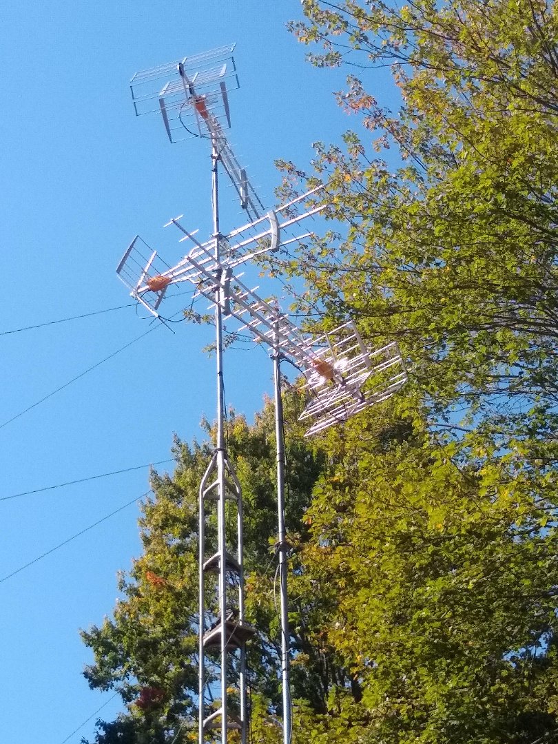

I have a free standing 30 ft tower with a 3x3 by 4ft deep foundation. It a hinged tower. I have a preamp on it and the power inserter is 125 feet from the ground rod at the tower base and the 32 feet to the antenna. I have not touched it in 4 years and still have excellent reception
