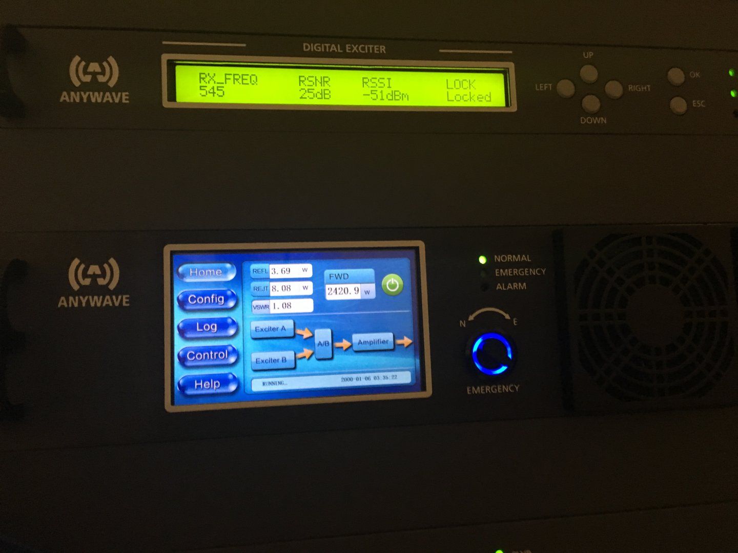

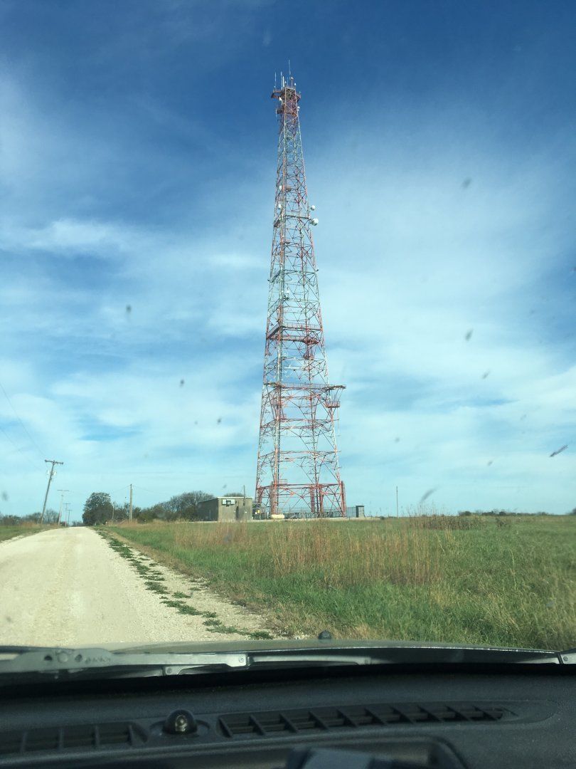

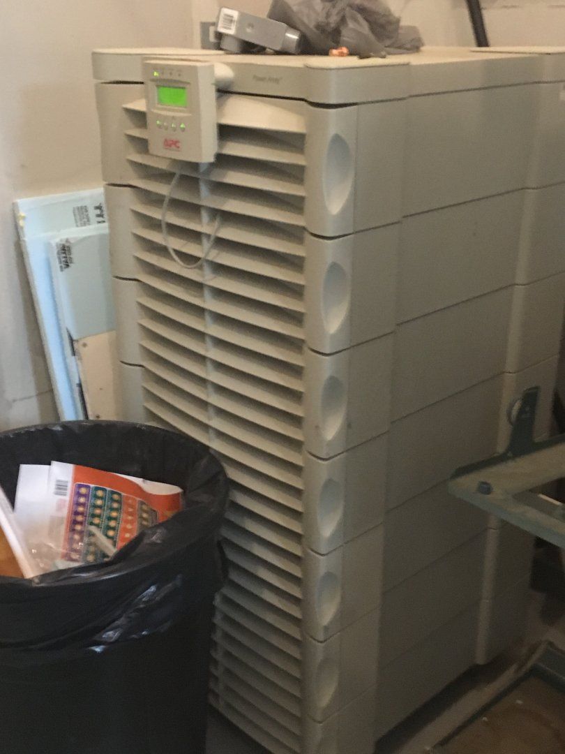

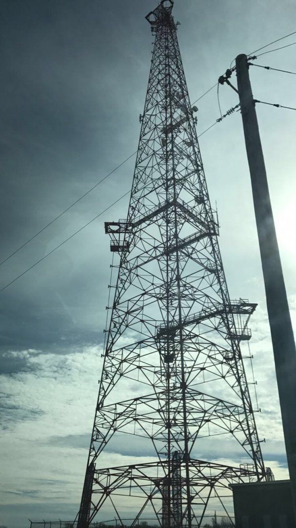

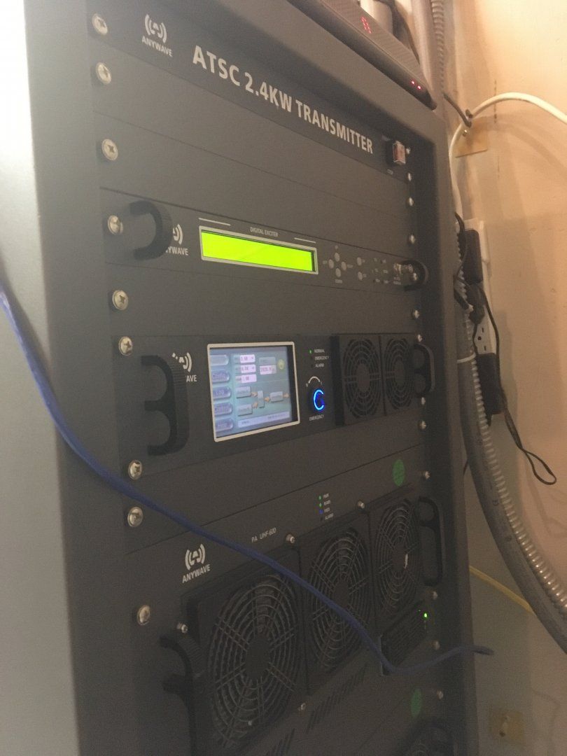

The transmitter for KMJC in Louisburg, Kansas is already 3.0 ready and has been since it went on the air :)
Hmmm. Correct me if I'm wrong. The transmitting antenna is shaped for the frequency, and maybe power. It "doesn't care" if the signal is ATSC or ATSC 3.
And in my mind, a transmitter just boosts an incoming signal and sends it out. The shaping, the placement of data to ride the carrier signal, is really done by, or used to be done by, a separate piece of equipment. Now, I guess these two functions have been largely consolidated into one piece of equipment.
Corrections or confirmations, please.
