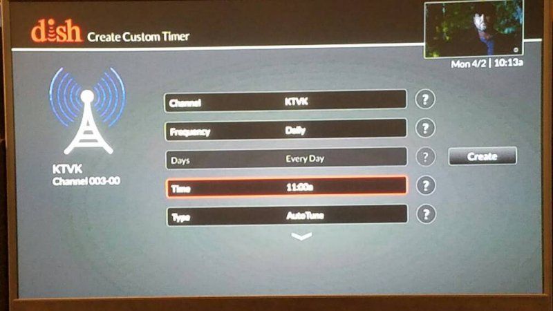

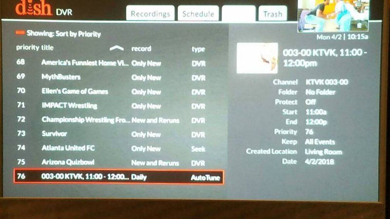

Hopper3/joey manual autotune timer,
At the tv you want autotuned,
Press 'dvr' to access recordings,
Move to 'Timers' tab,
Press 'red' button for 'showing...',
Press '3 create a timer',
At 'type' change 'dvr' to 'AutoTune',
Change other items to match channel, time, etc.
I know this and as said I set the timer but if the name of teh show is not the same it is dead
Does not matter the name of the show,
Thid sets a MANUAL timer to AutoTune a reciever to Channel & Time & Frequency.
Program name is not involved
Program name is not involvedView attachment 132226

However, I wonder if yours it tuning to KTVK instead of channel 003-00?
