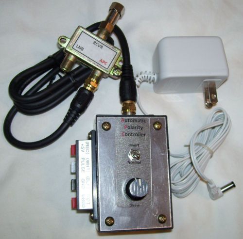

I found this item on ebay. Do any of you guys able to check this out ? Do you think this will work good ?

Very tempted to order one.
Inside the house by the receiver.
So then I need co rotor cables run to the dish from the house?
Was hoping to go coax to the dish then from the box to the servo.
My question is where does it go? Inside the house or out by the dish? I don't have power out by the dish.

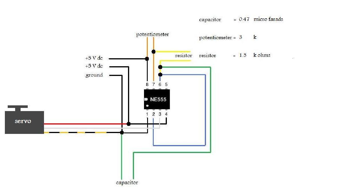

You could put in a weather proof box by your dish and not have to run wires into the house, but if you want to tweak the skew, you have to go outside. I would run an 18/3 (18 AWG 3 wire) into the house and put the device beside the STB. I use a less sophisticated design for the same purpose (see photo).
Yeah you would have to run another set of wires to the dish for the polar-rotor. You could use something small like cat-5 for that, so would not be very hard. I guess you could put at dish if you ran power out there. I think running control wires would be way easier. Also you can adjust the polarity with the knob to find the "sweet spot". It comes in very handy on some signals.

This is a new, home made item.
Well, some enterprising individual, eh? :)
NOTE: The "vertical" output voltage (about 13V dc) from an FTA receiver may be too low for proper operation of some LNBs. In that case, a power inserter (not supplied) may be used between the receiver and the LNB to supply a higher voltage for proper LNB operation.

guacharaca,
Nice and simple! ...and likely can be "automated" with just a few extra components. What freq/duty cycle span do you get with the listed R/C values?
