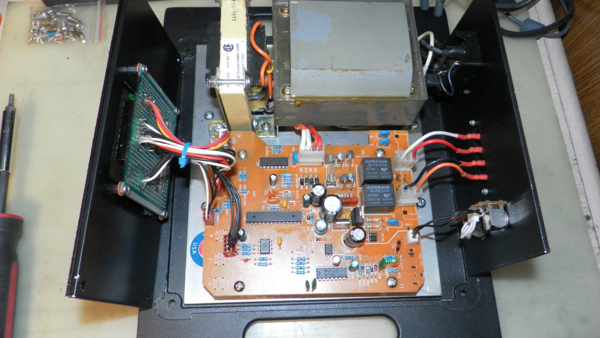

I kinda figured as much and I thought about voiding the warranty by opening the box to see if the cables can be easily reversed. But the manual I have says that the west button is on the right, next to the power button. As I have already mentioned, that button moves the dish east instead of west. Not a real big deal. Well, I guess it's a big deal because it has me growling.
There are no cables to reverse. The buttons on the case push directly on the switches attached to the circuit board. Here is a picture of the board with the switches removed and cables installed for a custom build.

Nice looking build. I try not to do stuff like this since it costs money and quite a bit of time to do these mods.
When it's a hobby you don't think about the time investment. And I'm sure I have less invested in my custom build than you paid for the PR1200. ;) Most all the pieces I used were repurposed from discarded boxes. A desoldering gun was one of the best tools I bought. :)
