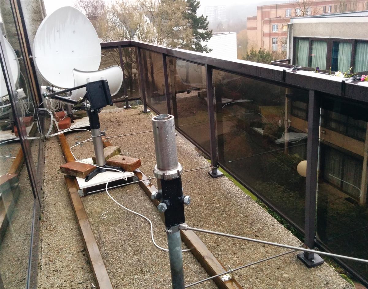

I did installation on my balcony (actually inside the balcony) on self-made non-penetrating wooden platform. Of course, balcony defers from another balcony and individual solutions should be found.
Well, we would like to be able to sit on our balcony, too--from the photo, your solution seems to preclude that! (And the clamps on the bottom of the balcony railings would probably cause it to be rejected.)
There is exactly the same balcony other side of the house, so if somebody wants to have "coffin nail" or just relax, he/she can go there. :shh But, even on this balcony is some place left (from where picture was taken). Clamps, I added just in case, but, in reality, nothing is moving there and tornadoes do not come inside the balcony.

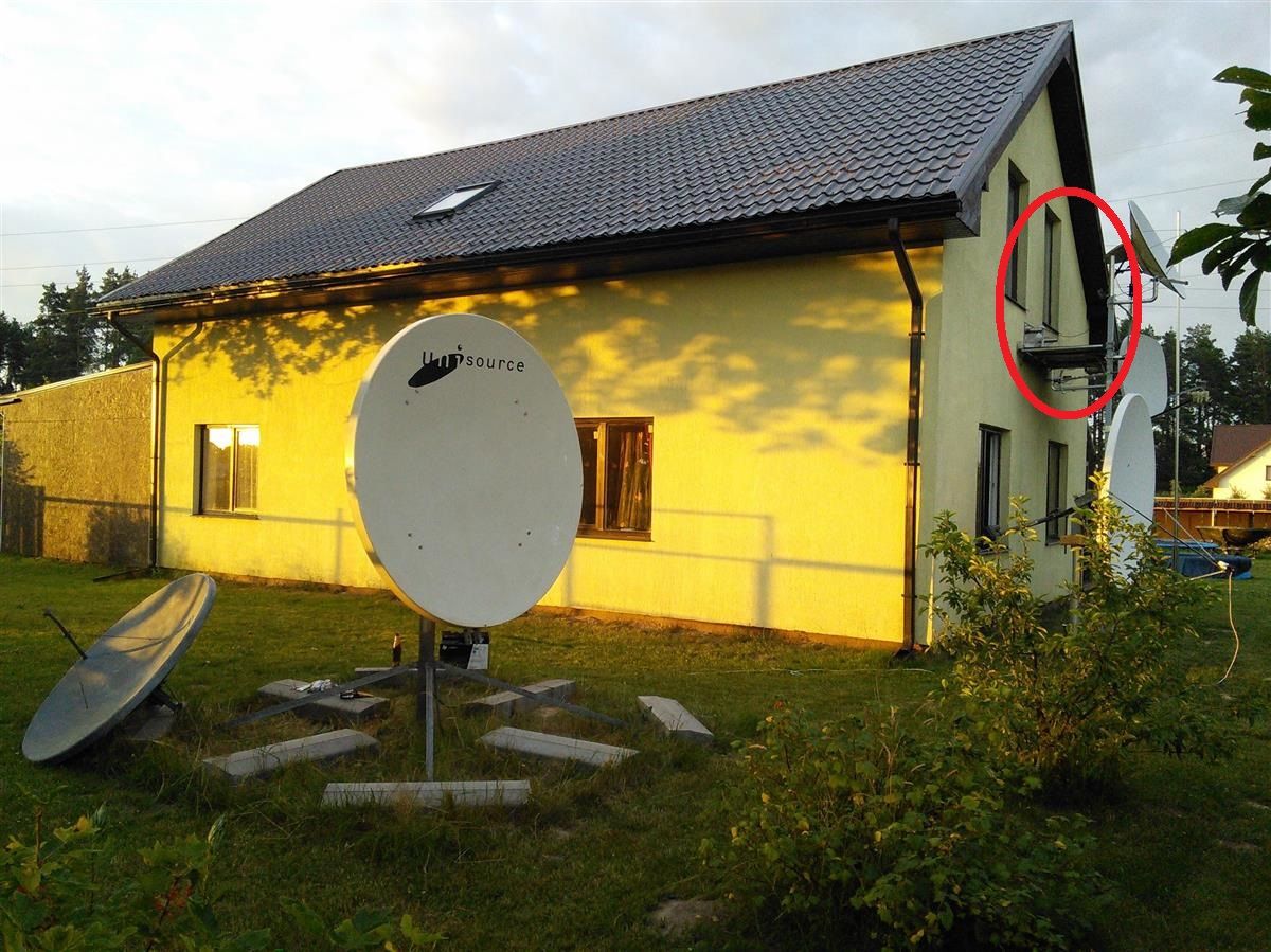

Add: I more like my another balcony, south-facing, where I have no major restrictions
