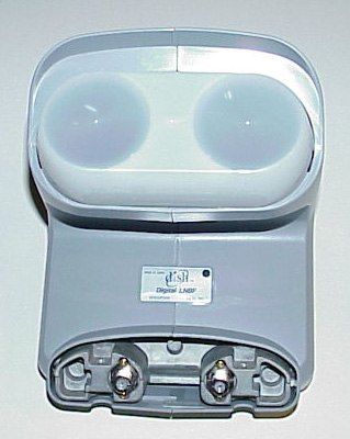

terminology
The first picture is a TWIN
Has ability to receive two satellites in the one enclosure
Has internal switching -
- legacy model isn't usually controllable by much but a Dish receiver
- Dish Pro model is diseqc compatible, and can be controlled easily by most everything.
The second picture is a regular Dish LNB with two outputs.
It comes in two flavors -
- if legacy it can be connected to FTA receivers with 22khz or diseqc switches
- if DishPro, it can be connected using 22khz or diseqc switches.
For DishPro LNBs, the receiver must know how to talk to band-stacked LNBs which don't use 13/18 volts for V/H switching.
To my knowledge, BEV doesn't sell DishPro LNBs of any sort.
Or if they have started, they will be far less common than legacy.

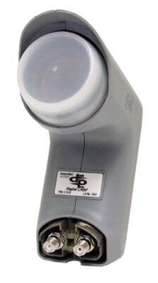

DishPro always have a prominent dp logo on them, as shown on the right picture.
If it doesn't clearly say DishPro, it isn't!
