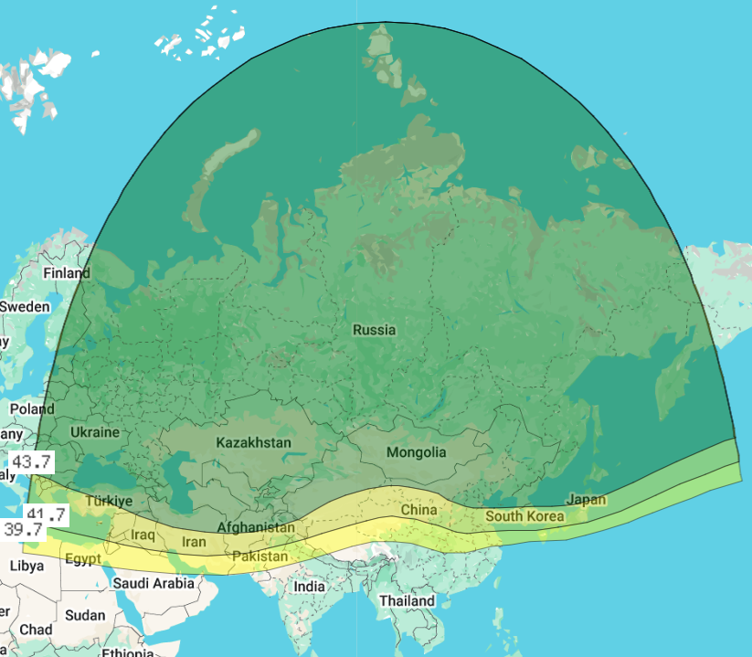

I am in Japan and I am actively attempting to receive the Korean Central TV signal on C-band here. The signal originates from 96.5E Express 103. It is reported to be 42 dBW at my location so it should be easily receivable on my 1-metre dish. It seems I have no 5G interference in my particular location that I'm aware of which may allow me to receive it.
I am being slowed by mundane temporary problems. When renovations on my home are complete so I can re-install my dish in my yard then I will be able to see around my neighbour's house. This will allow me to view the satellite at 96.5E Express 103. This satellite carries the Korean station in HD quality.
Korean Central TV footprint from 96.5E Express 103:
