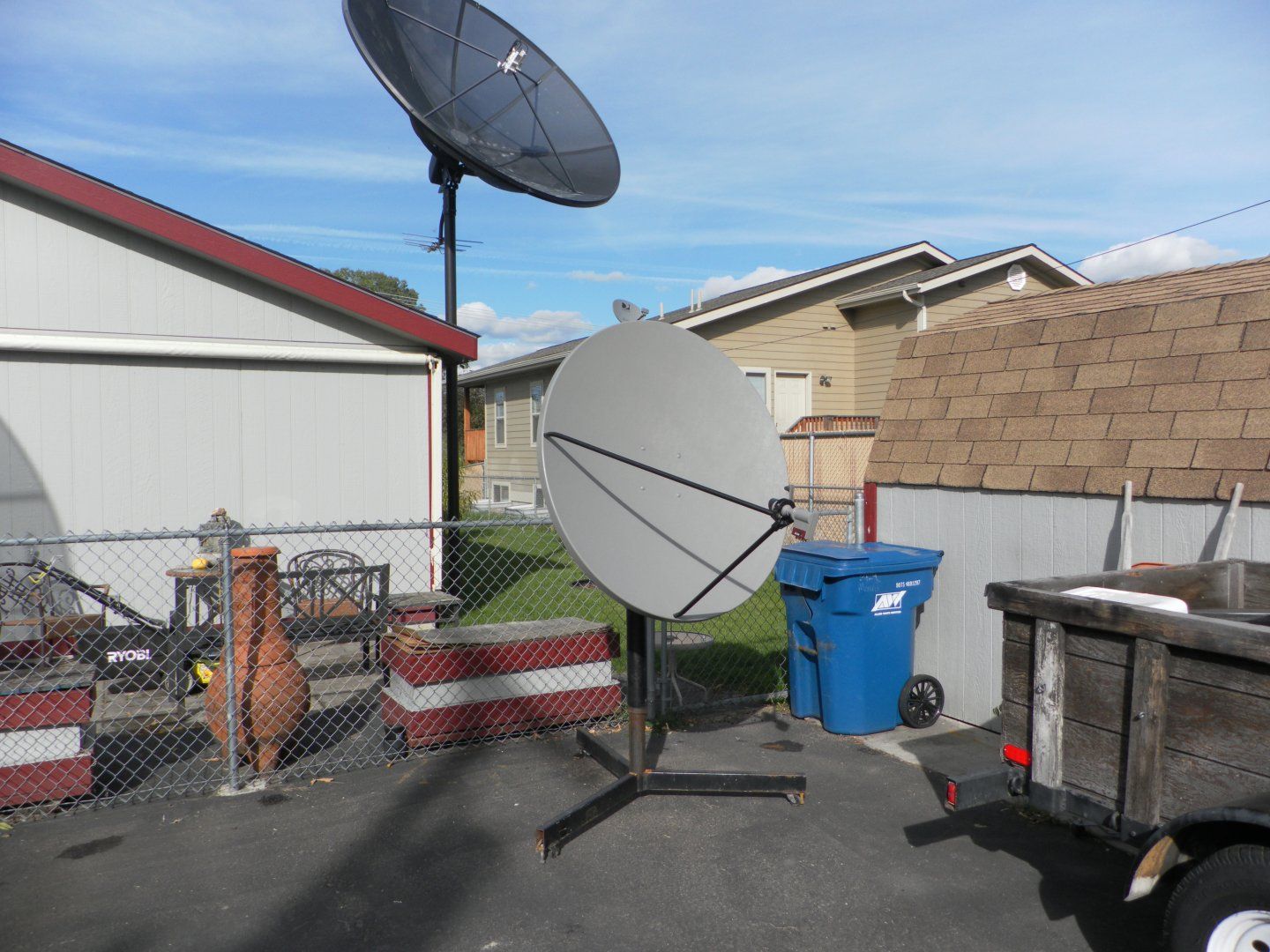

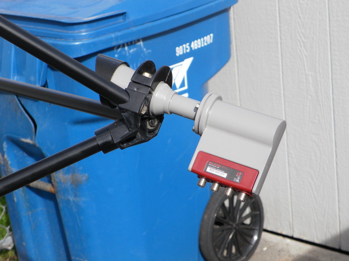

1st lets define something. The GeoSat SLPLL is an LNBF (LNB with built in feed horn). To increase performance we want to match the Feedhorn to the dish. Using a dish with matching feed we can then select a high quality LNB to use and expect maximum performance for the size of dish. For example: My Ku dish is a 1.2m Channel Master with the correct feed horn and an Inverto Black Pro LNB
My 1.8 Prodelin is the best Ku dish :biggrin2
BUT its huge and impractical for what I'm doing right now so its going to stay in the corner in the backyard til I can get me some land.
