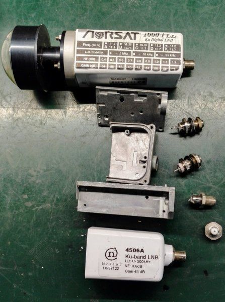

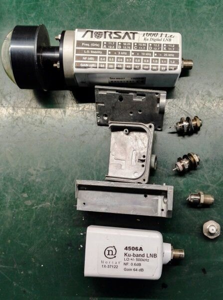

dtvh8r Could you show some picture of your LNB? If you can not manage to remove piece of wire in the drum you could probably disassemble LNB and change the drum. I have some of them available, you only pay shipping. If your LNB looks like om my picture, then unscrew nut from the F-drum and remove the body of the LNB. IMG_20170105_150236 (Custom).jpg
