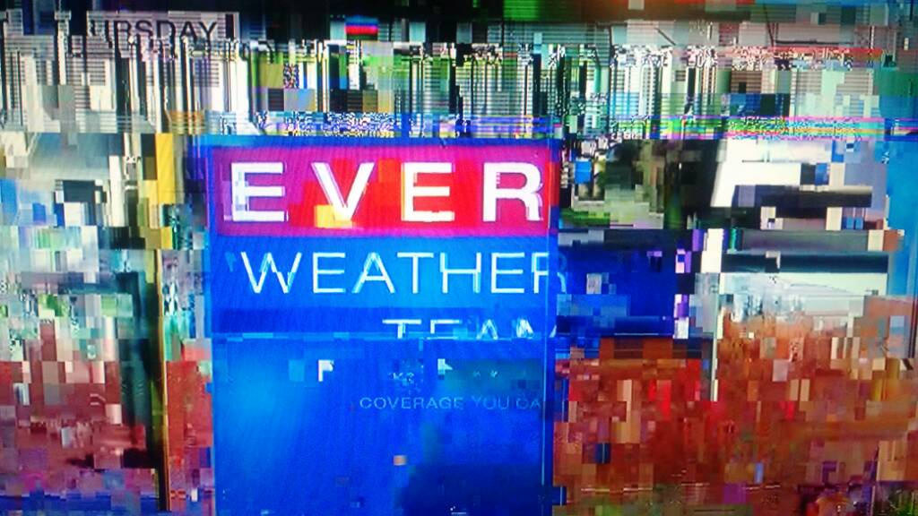

Here is a picture of today's morning news.
