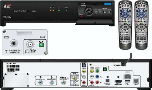

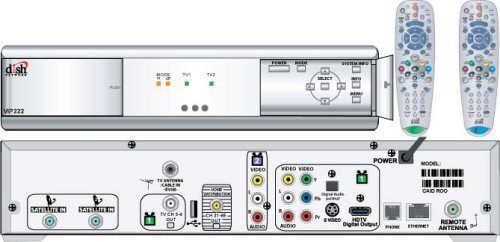

The 222k has the OTA built in. Only the 722k & 922 need the OTA module added.
33c351c88da0bb9761f43210.L.jpg<<<< 222k.
KEWL as I said I knew there were 2 diff units. So the K is the newer version like the 722k that needs the OTA module. Maybe 1 day there will be the ability to add an ext HDD.
