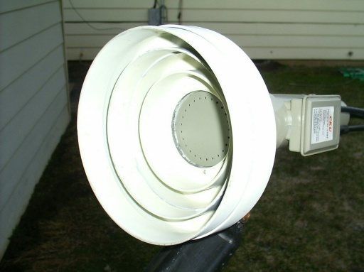

PSB On vacation Nov 5, 2003 3 5 Jul 3, 2006 #2 Its designed for a prime focus dish, so if you were to use it on an off-set dish you would have to use a special cone shaped scalar ring that has been designed for this purpose. I use a 6' mesh dish and get GREAT results! Attachments Pict0037.JPG 25.7 KB · Views: 198

PSB On vacation Nov 5, 2003 3 5 Jul 3, 2006 #4 This one was hand made by member Alec, (Who has not been around since Feb. Hope all is well there?) Mentioned here......... http://www.satelliteguys.us/showthread.php?t=39119&page=13
