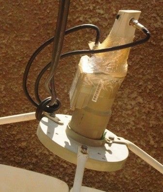

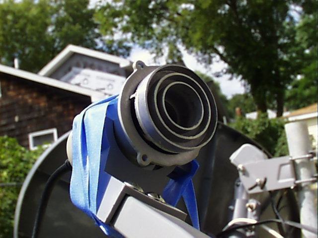

Could you post a photo looking down the feedhorn? It would see to me that a proper Ku scalar for a prime focus dish would completely block the C-band waveguide.

Found two pictures.
First picture is from BSC-621 post on this site in 2008 and it shows the Ku scalar but it is not conical it is a flat ku scalar.
Second picture is from another site and shows a Ku circular lnbf bugerd to a C Band LNBF.
Found two pictures.
Thanks, but I'm not entirely sure what I'm looking at. Does the first picture show what is at the back of C-band waveguide, ie. removed from the tube? If so this seems way too far from the focal point to have any real effect as a Ku-band scalar and that might explain why this unit didn't win any prizes in the Ku department. I'm sorry if I'm not getting it.
