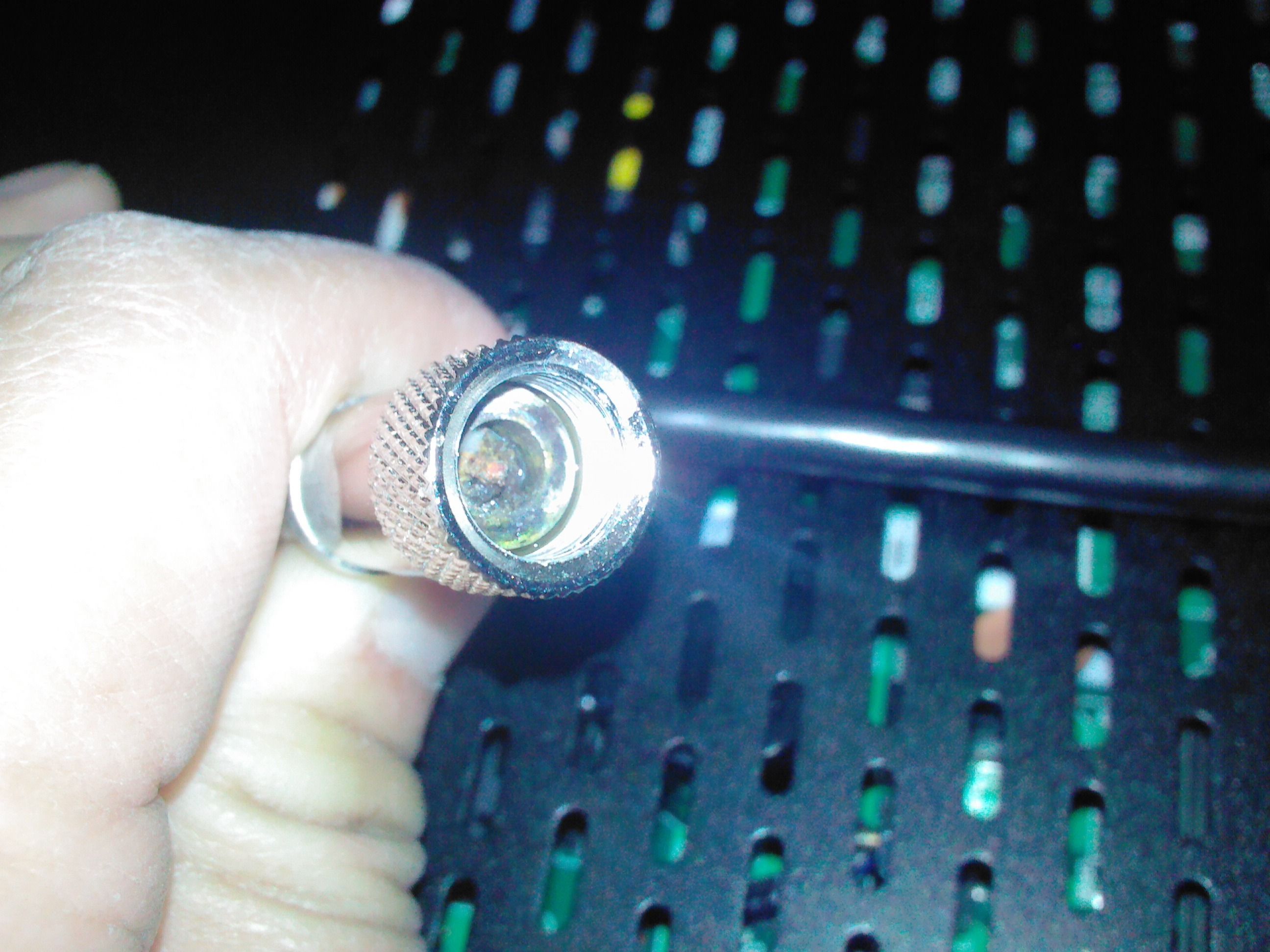

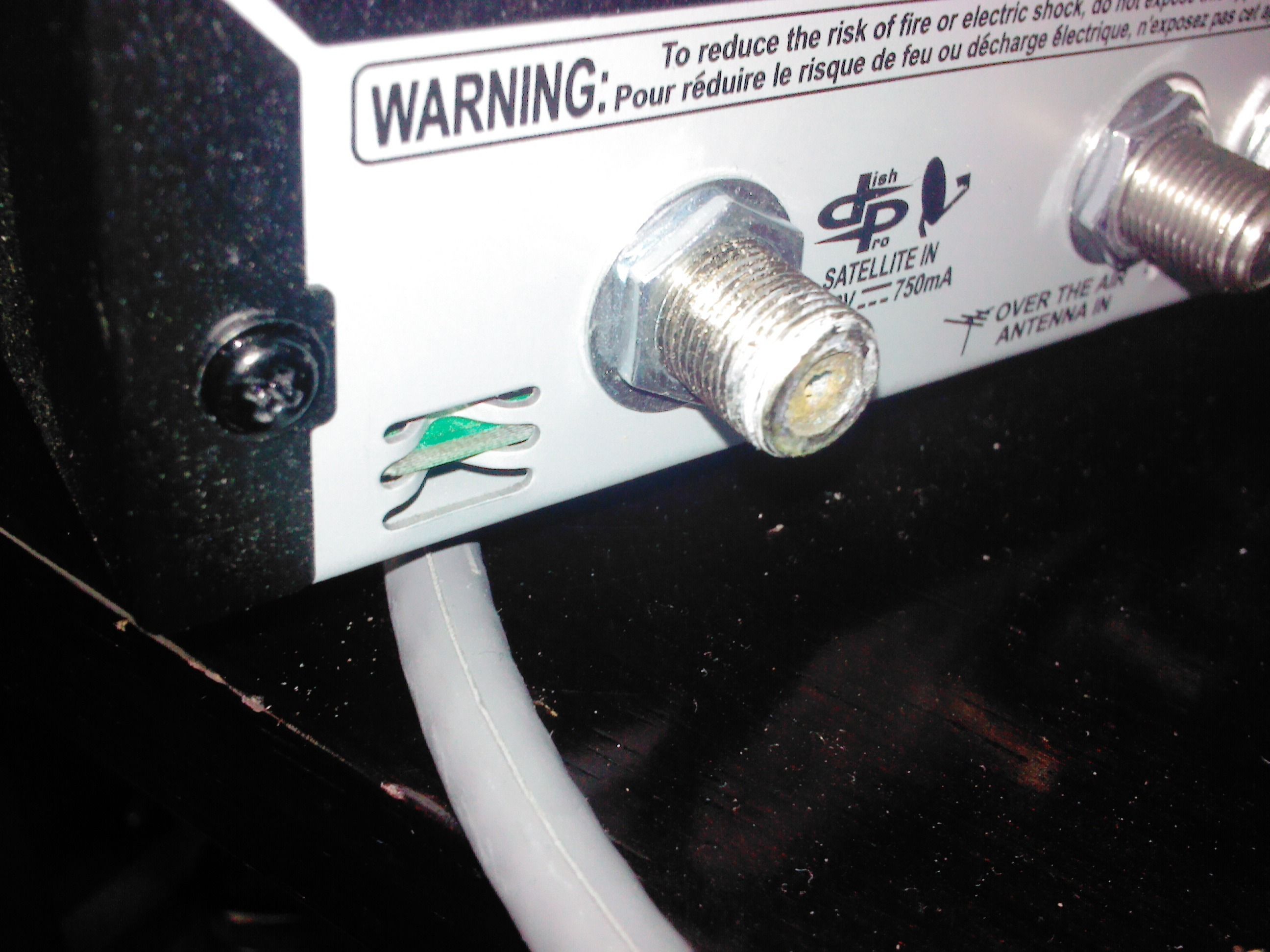

Hi everyone,
I have a dish network set top box and the center pin of the cable coming from the satellite dish has been burning off.
The same dish is feeding two other dish set top box and those are fine. Could this set top box be bad?

it is not corrosion as i recently installed the cable.
here are some pics.

To me it appears the connector was not correctly installed. It also looks like a "twist on" that possibly had some braid touching the center conductor.
Water in the line, i have seen water get all the way up to the recver..
