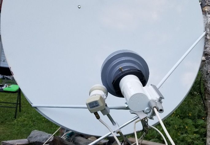

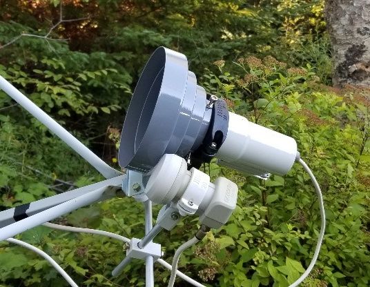

I have installed my GEOSATpro SL1PLL Ku LNB on my motorized 1.2m dish with Titanium C1PLL LNBF and CS1 scalar. This allows me to receive C- and Ku-band satellites on the same dish. Currently, I am receiving on C-band 91W, 97W, 99W, 105W, 107.3W, 113W. On Ku, I am receiving 87W, 89W, 91W, 95W, 97W, 99W, 103W.
Pics below show orientation of the LNB and LNBF. I have a +6-degree offset programmed for each motor position when using the Ku LNB. For example, when I want to watch 87W Ku, then the motor is programmed to point at 93W. After this novelty wears off, I will install a second Ku LNB on the other side of the scalar. I would program the motor with a -6-degree offset for that LNB. Installing the next Ku LNB will minimize the range of travel the motor will have to do to receive Ku from 87W to 123W.
