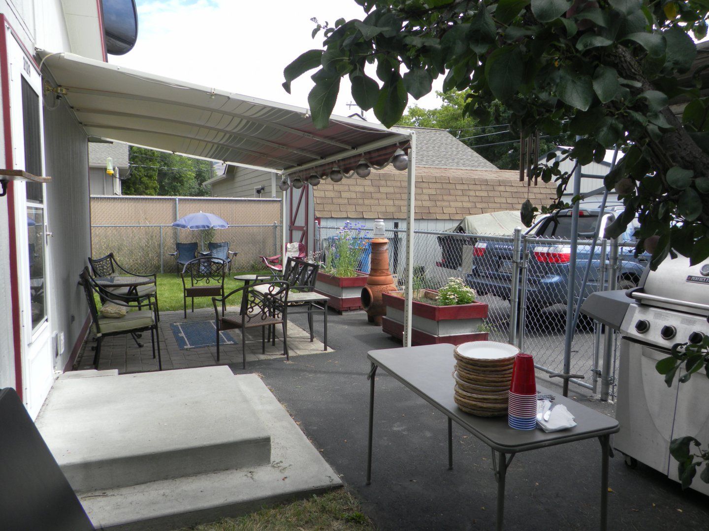

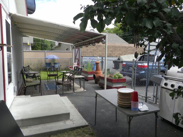

I used pavers to fill in a hole where a shed stood. Turned out good. 88BBQ 015.JPG

I used pavers at my previous house to cover a hole where there was an in-ground jacuzzi. After about a year there was settling and the pavers were very uneven.
I should have used a power compactor to prepare the ground before paving it. Had to partially re-do it before selling the house. Lesson learned.

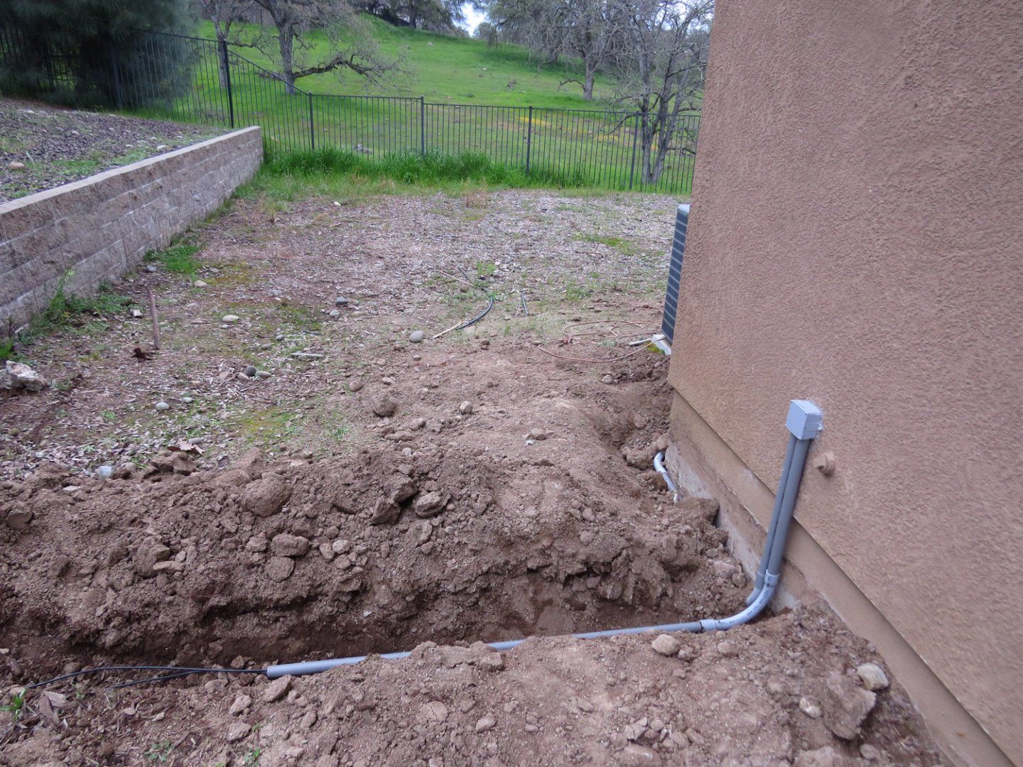

Today I finally finished the 50 foot run to the Birdview, and started on a shorter (30 foot) line to the Unimesh. Since the Unimesh line is not under concrete I am just going to bury the cables (without PVC conduit).
The ground here consists of 60% heavy clay and 40% boulders. Trenching is not fun!! But I do have a jackhammer which cuts through the rock and clay pretty quick.

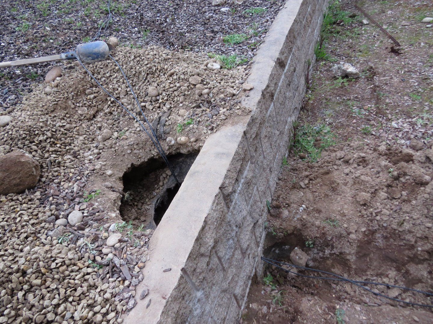

For the Unimesh line, I have to go through a concrete retaining wall. Drilling through it required renting a heavy duty masonry drill from Home Depot. Now the hard part is digging down through the back (earth) side of the wall to be able to run the cables through.

Today with rain on the way I wanted to finish running the second line through the retaining wall -- before it all becomes a muddy mess. Digging through the gravel behind the wall seemed like a losing proposition. I would dig out one scoop and then two scoops of gravel would cave in to take its place! But after several hours I finally got down to the horizontal hole through the wall and threaded the two cables through. There were two layers of landscape fabric which helped reduce the cave ins.
Sure glad that this is done.
I'm using PVC only for the part of the Unimesh trench that will be under sidewalk. The Birdview line going around the corner is all PVC.
