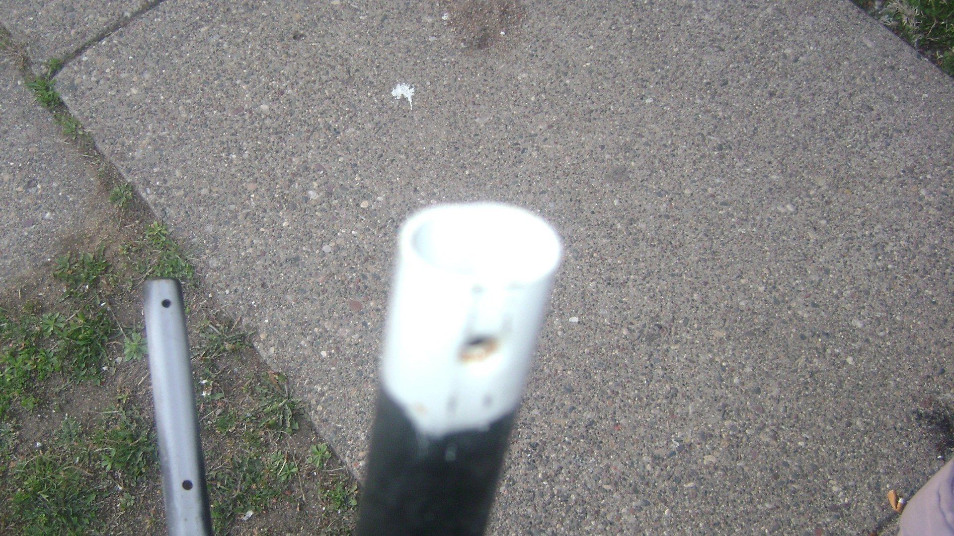

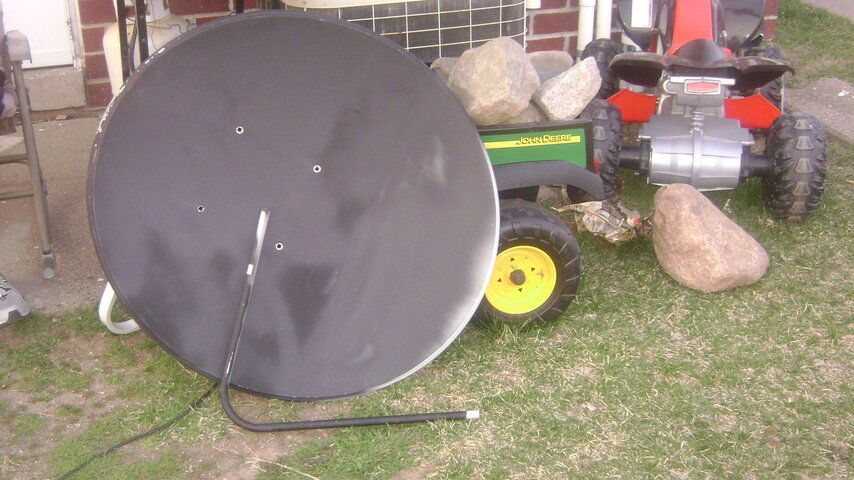

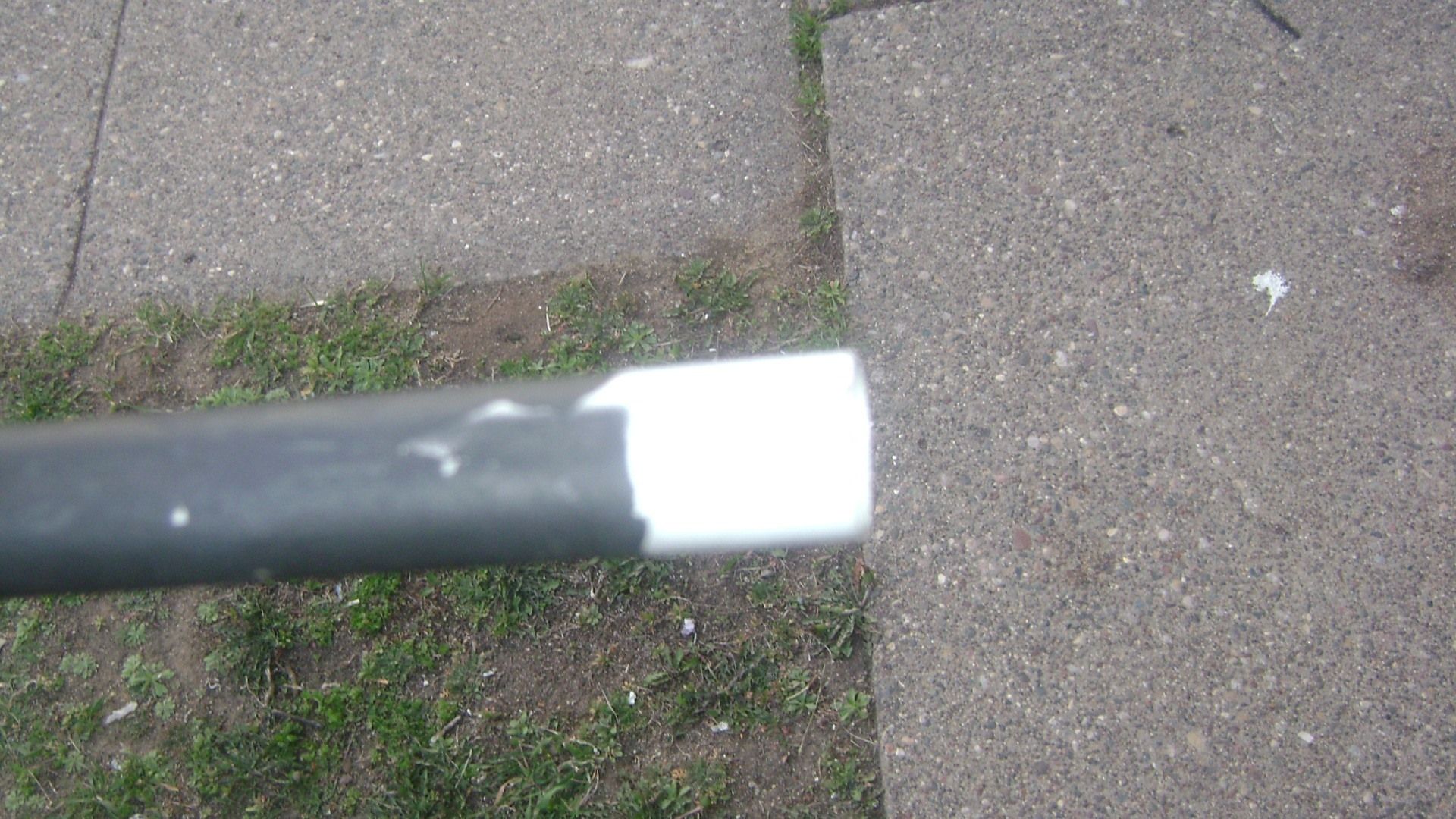

hey guys i need a lttle help please
here re few shots of my dish
need help trying to i dentfy this
also trying to find the right lnb holder

i realy need some help please
i need to find an lnb hoder that works with this set up
haveing major problems with signal
thanks

Take a few shots of the mount on the back of the dish.
Maybe it'll look familiar to someone.
What are the measurements of the dish? Height and width.
I assume it's stamped steel?
Where did you find it?

Well it is was white, looks like my LNB arm on my dish, Now it is painted and the picture is a bit fuzzy but it looks like a Fortec Star! I would say it is a Fortec Star dish! I would say a 80CM. Docj, get us a picture of the dish mount, where the dish mounts to the back. If it is a Fortec Star, the holder can be bought HERE!
Sure looks like that it is a Fortec Star dish!

Try finding the "sweet spot" with some small mirror pieces on the dish and a pocket laser pointer. You can probably fab something pretty easy for most any lnb once you have a good idea where it wants to be.
