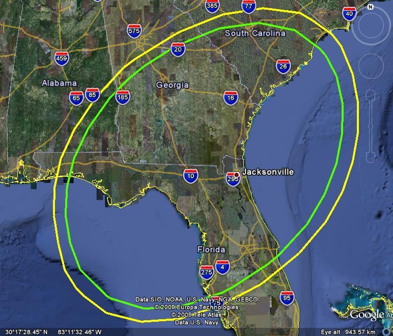

http://www.satelliteguys.us/thelist/index.php?search=dnall&market=Tallahassee, FL&sub=true&sort=&order=&beamMap=E10_SB3.jpg
Check your signal strength on transponder 25 on the 110. I'm guessing its weak or non existent. You may need to peak the dish, especially if you location is near the edge of the spotbeam.
Guess I'm back to square one since the check switch doesn't work and I have a connection to 110 and 119. Maybe I am out of the spotbeam. Just odd that the locals were working and now they aren't. I guess I must have been seeing 129 for the HD local channels at home. I'm at a loss.
