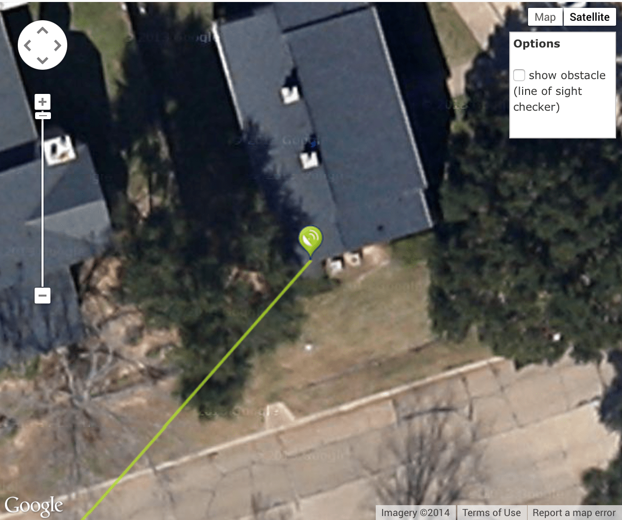

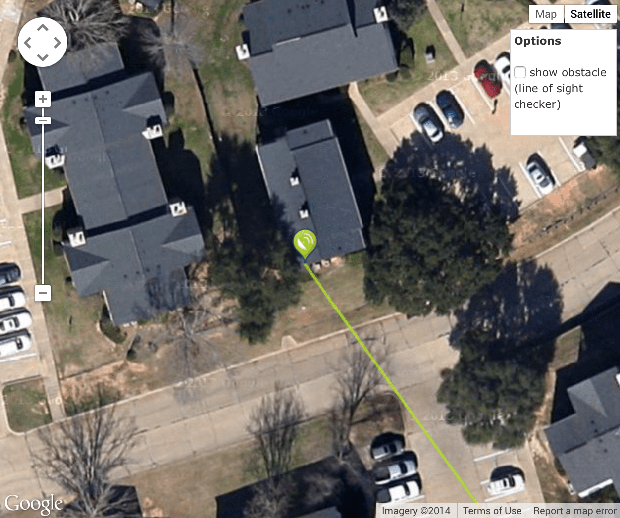

Almost all of the Dish 1000.2 are blocked. The Dish tech came out today and confirmed this. I select Dish 1000.4 on dishpointer.com and I'm good to go. I also verified the location with an iPhone app. I'll attach some pictures for reference. The first photo is 1000.2 and the second is 1000.4. I don't need to point towards 129 do I if I point toward 1000.4 satellites right?
