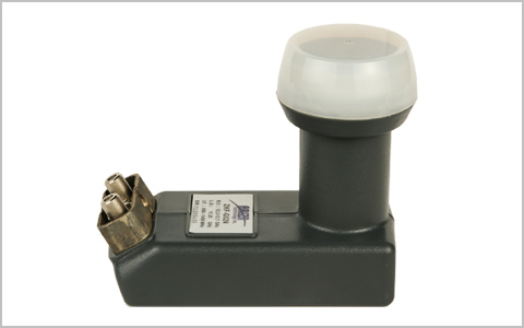

Im assuming this is the LNB your referring to Iceberg?
Can I use this one as well for 118.7?
You need to use a DISH 500+. You'll probably not manage a frankendish combo. As Iceberg points out as the DISH 500+/1000+ LNBs are the only ones that work.

I now understand I will need dish 500+ LNB's but is one of the pics I posted above a 500+LNB?If so which one? And if not can you post a pic of what exactly is a 500+lnb?
It isn't so much a set of LNBs as a one-piece module. It works only with the Plus dish, so if it comes installed on a DISH 500+, it is the one you're looking for.
My understanding is that it won't fit any other dish without modification (this is a good thing as it needs the bigger dish for the low-power signal from 118.75W).
yes to ytour first question..No to your second.
There is no way , without undertaking a mad scientist project, to use a standard single LNB to receive 118.7.
118.7 is a Fixed Service Satellite that sends horizontal and vertical polarity.
Most Dish LNB's receive Digital Satellite Service. Circular (left and right) polarity.
actually 118.7 sends circular polarity...its using the FSS band (11.7-12.2 Ghz) versus DBS which is 12.2-12.75Ghz
