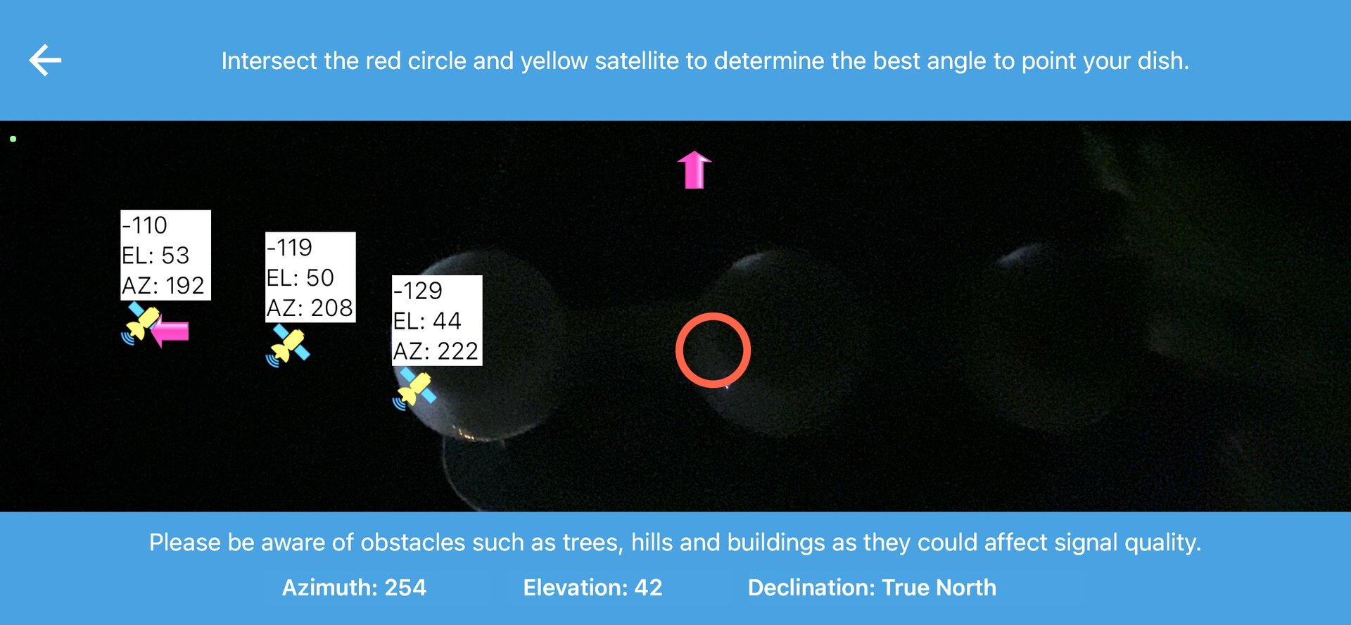

No obstructions but does look like it's off. Centered camera lens on LNB arm and took this shot. Looks off?
Guess my elevation is off is why I'm going too far West to get signal. Correct?
After looking at the pic, I went back out and checked my numbers again. Elevation is indeed off by about 5*. Guess I was reading the scale backwards (nothing new for me LOL!). Will reset it tomorrow. I knew it was something simple!

No obstructions but does look like it's off. Centered camera lens on LNB arm and took this shot. Looks off?View attachment 159082
It looks that way. Don't forget you may need to tweak the elevation a little to optimize all three signals. I suggest snugging the mount clamp up until you can just rotate for alignment. That helps eliminate any drooping from excess play that throws off the elevation a little.
