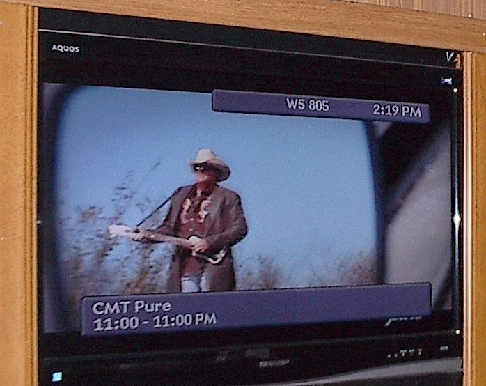

Confirmed. The Key expired today for us. No channels on w5, will check w3 later but bet they are also gone bye-bye, too.
My W5 works since I'm on 4160. W3 still works since it is ZK.
