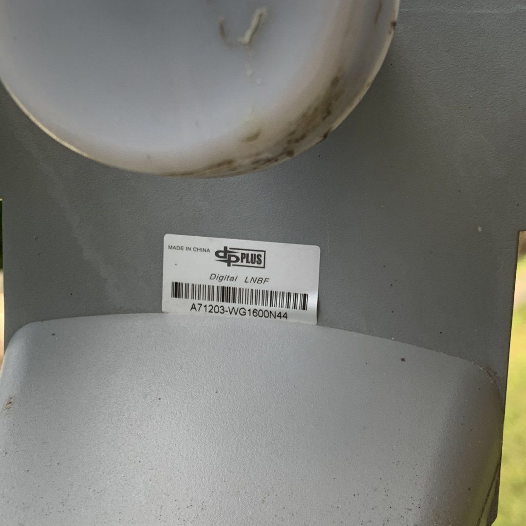

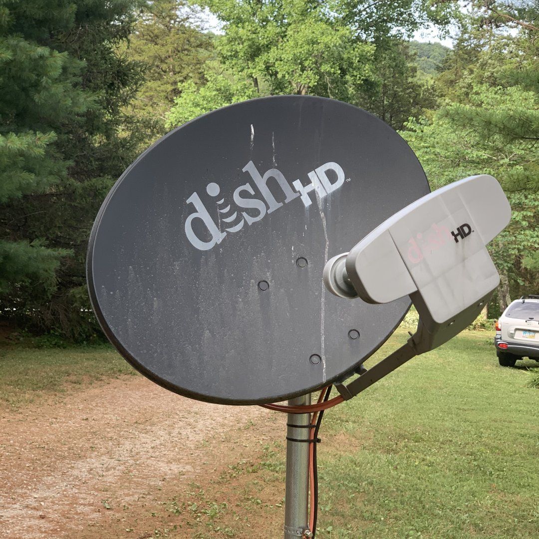

Thank you all for your replies. My dish is setup in Scioto county Ohio . I would like to get Columbus local channels. The dish at my home was just installed this spring. The dish at my camper is in the attached picture. The dish at the camper was being used last year with Columbus channels.

Your dish looks like a Western Arc dish, so you are all set, since the Columbus locals are all on the 129 satellite. All you need is a service address in the Columbus market, to be able to receive those locals.

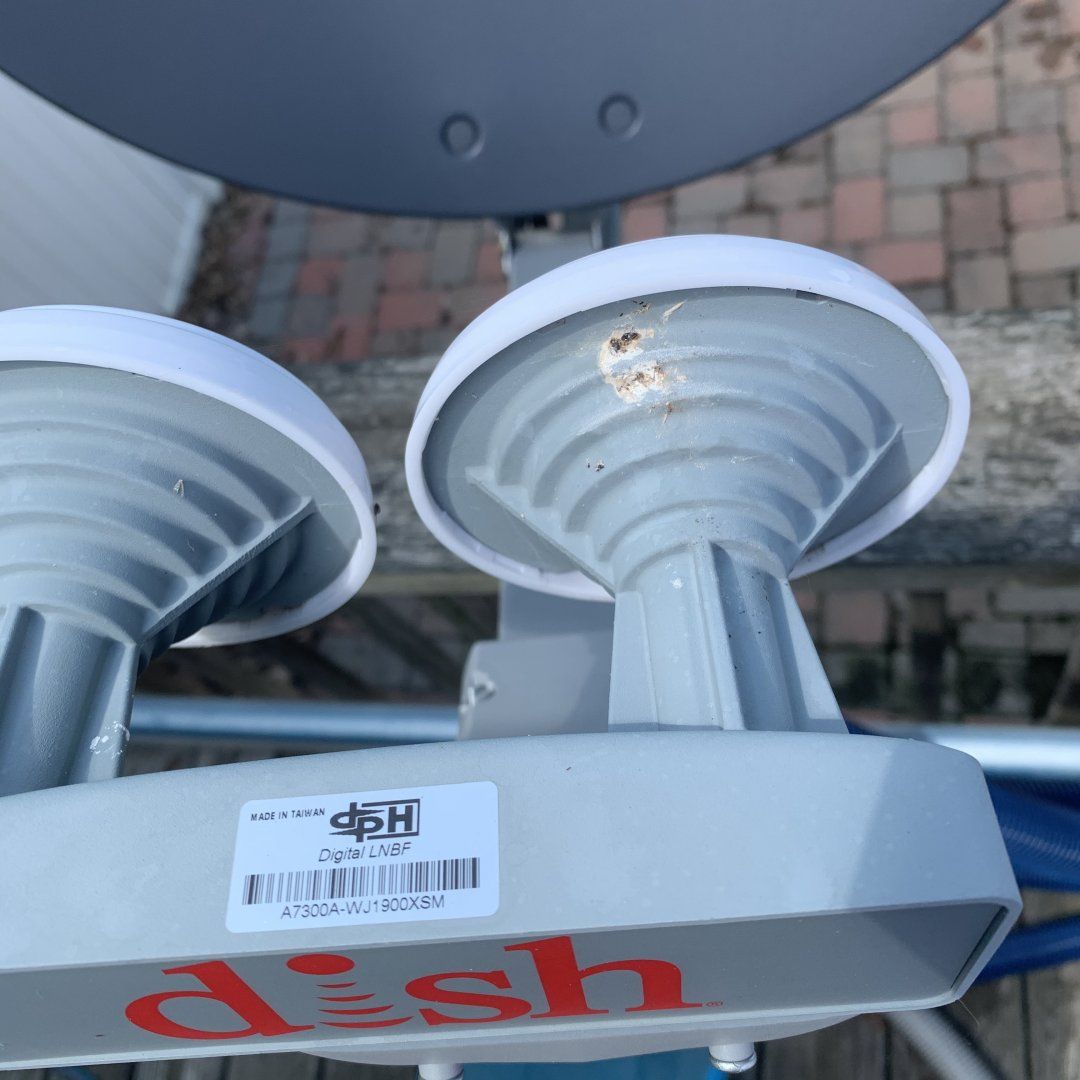

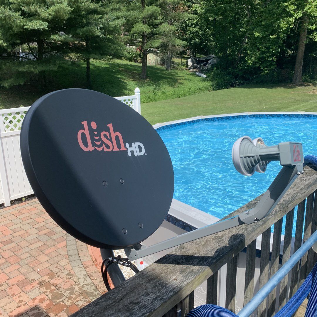

would the dish in these photos work for Columbus?
No, that is an Eastern Arc LNB. Your options would be to either replace the LNB with a Western Arc LNB and re-aim the dish, or use a service address in the Zanesville market. Zanesville is on Eastern Arc, and most of the channels in their local package are actually from Columbus.
