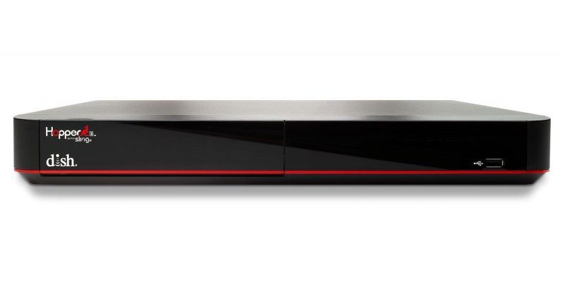

Look at the front of the Hopper, does it say "Hopper 3 with Sling and look like this?"

Sorry then. it is a Hopper for sure.
