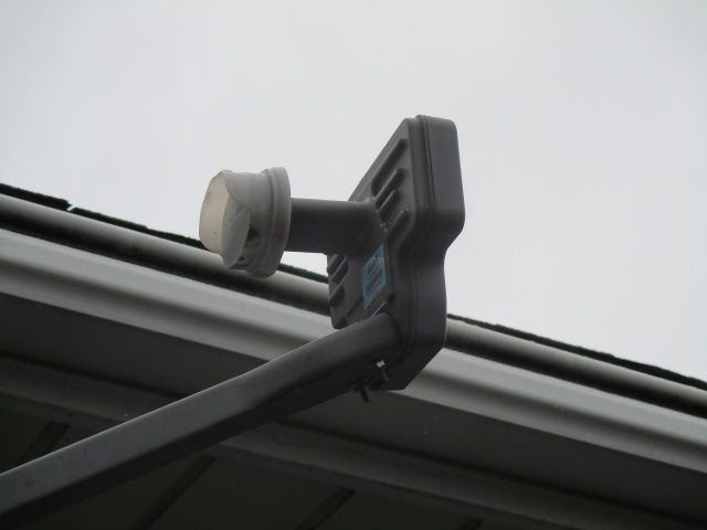

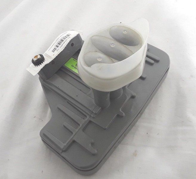

Here is a picture of mine. The ebay is a SL3, they look the same.
As long as you don't have a swm switch, that's the correct lnb. How many cables coming from the dish? If one, you are good to go.
