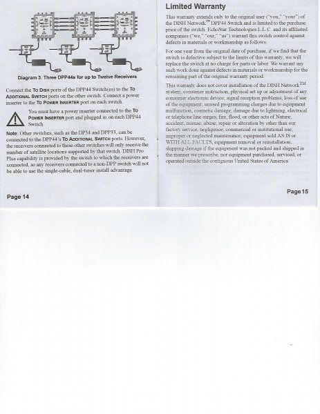

I'm starting to think I'm chasing a myth. Someone on here suggested using a channel stack splitter with a DPH system to connect multiple Wally receivers as an alternative to cascading DPP44 switches but I haven't been able to find any channel stack splitters for Dish and I haven't heard pros like Hipkat mention them. This seems odd to me because I've always been able to easily find and buy any Dish equipment.
BTW does anyone know how many DPP44 switches can be connected to a dish?
Thank you for your reply and all the great info.

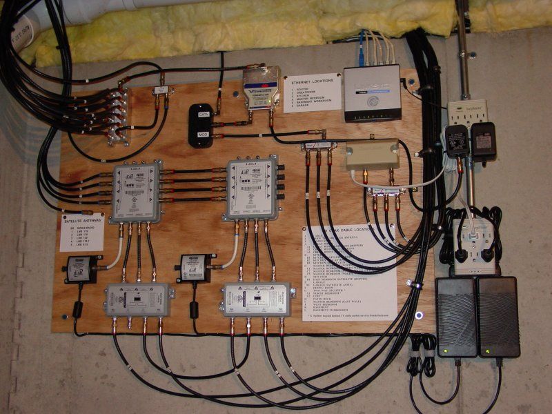

I have seen a diagram for six DPP44 switches. When I had four HWSs I had two switches connected to a DISH 1000+ dish.
Four Hoppers? :eeek
Here is a pic of my headend when I had four HWSs and one Joey 1.
