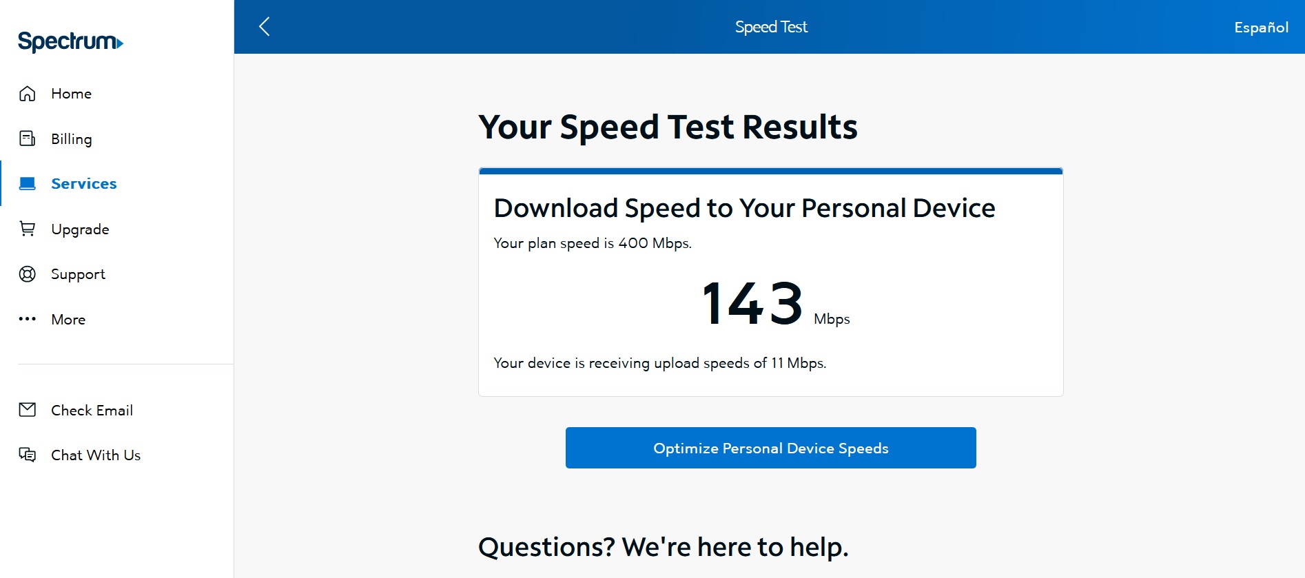

Yes, they replaced a splitter to even get it that high, when my modem and speed was upgraded to the 300/10 speeds. They originally sent me a "self install" kit with the new modem, and it didn't change my speed from the old 100/10. So, tech came and replaced an ancient splitter from back when I had cable AND internet, and that upped me to 175/10. I can't remember now if he installed a newer splitter, or replaced it with a coax to coax connector. It comes up behind and in the middle of a HUGE tv stand, and it's not easy to get back there without a major operation.
What modem did they give you? If anything other than one of the D3.1 Spectrum branded modems from Ubee, Hitron, Technicolor or Sercomm exchange it. I would push for a Technicolor or Ubee personally.
If you plug the modem directly into a PC with a 1 Gb (or greater) NIC, bypassing all routers and switches with a brand new CAT5/5e/6 cable what is the result?
Also to rule out LAN hardware issues, have you tried to transfer a single large file across your LAN to see if the transfer rate exceeds 22 MBps?
If you do a speedtest in the middle of the night what are your results? 300 x 10 should get you just under 360 x 12 with the 20% overprovision minus the TCP/IP overhead.
When the tech was out, what speeds was he getting on his meter? Their new meters have the ability to run speed tests on them. The can plug it directly into the coax or have the coax plug into the modem and use the modems ethernet port to plug into their meter.
Did the tech mention the signal and SNR levels? Did he notice anything off with the downstream ODFM channel?
Is the splitter balanced ot unbalanced? If unbalanced is the modem on the -3.5 leg or - 7 leg
Any security software inplay that can be disabled? Can't speak for present day, but in the past with certain Network Intrusion features enabled in Symantec Endpoint Protection, my WAN speeds dropped to 600 - 650 Mbps.
Hitron EN2251 My router is a Netgear Nighthawk AC1900 R7000, and it's updated with the newest firmware from a few months ago.
Tried that years ago with the old modem, and it MARRIED the modem to the laptop (Charter did this for some strange reason). It was a bitch to get it uncoupled, and back to working with my router. Not going to try it again.
Maxes out at about 28.2 MB/s (edit 4:36pm)
Will have to try that later. 175MB/s 4am
Don't remember, but he checked right at the pole, right at the input to the side of the house Dmarc box, and right at the modem before and AFTER replacing the splitter he determined was the biggest issue.
Don't remember, but he had the modem re-provisioned by calling in. By the way, back when he was here, it was only promised to be like 200/10 at that time, and I've seen it as fast as 178 MB/s. Not sure when they supposedly UPPED me to 400/10, but I've NEVER gotten speeds like that.
When they first offered high speed here, it was like 30/10. Then some years later, went to 100/10, then later to 200/10. Now they claim 400/10.
It was a coax coupler. I removed it, and pulled the coax going to the Spectrum demarc box out more, (there was enough extra coiled up) and connected it directly to the modem. So, that jumper piece is now gone. It made no difference on the speed, as you can see below.
NO special security software on the router.

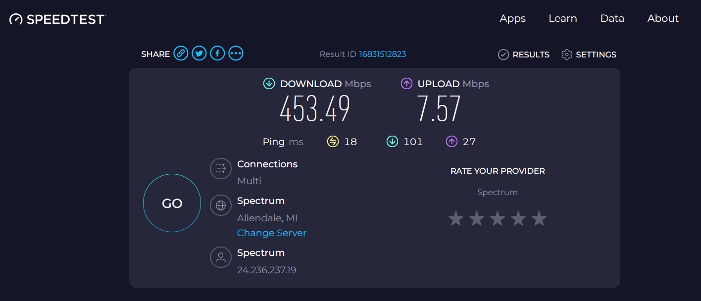

Just installed a new TP-Link Archer AX3000 router. Here's the difference between the new one, and my 8~ year old Netgear Nighthawk AC1900. Quite a difference, and I'm not 100% done doing some tweaks to it:
So do you still despise a company that was giving you the speeds you were paying for all along but couldn't achieve because your equipment was at fault and had nothing to do with Charter?
Glad you are seeing the speeds you are paying for. My Cisco RV320 router couldn't achieve gigabit speeds when I first upgraded to Gigabit in 2018, even though the ports were GigE. Not once did I blame Charter, I bought it's successor, the RV340 and get 900+ all the time ever since

I despise Charter/Spectrum for their pricing, which internet-ONLY just went to $82.99 a month for 300/10, (which by the way I never get higher than around 175~/10). But I really don't need any higher speed. I'd LOVE to find an internet provider that was under $50 a month, but there's nobody else here except TDS Telecom DSL, and TDS is far WORSE than Charter/Spectrum with outages and technical issues, and locked down network. I got rid of their POTS line 10 years ago, and was happy as a clam to do that.
IF you notice from my original post, which I linked above, I clearly stated that I despise Charter/Spectrum for their PRICING, which IMO, is far too high for an "internet-only" account. I NEVER said I despise them for the speeds they stated, or what I was getting with the old router.
Also by the way, I never expected THIS high of a difference, just because of swapping the router with a new one, or I'd have tried it a long time ago. This TP-Link router did about 90% of the configuration automatically, AND, got it all perfect compared to my original Netgear router that had to have nearly everything configured manually, and in depth. It was a great router, but I got about 8 years out of it before it started acting up these last few weeks, so I can't complain too much. To boot, the new TP-Link router was 1/2 the cost of the Netgear.
There's only 1 single thing the new router can't do: It doesn't have a built-in USB print server capability, and I would have liked that. I have an older Brother laser printer that's USB only. So, I'll have to get a print server to handle that. Or maybe I'll get a network laser. Not sure I want to lay out that much money for one though.
