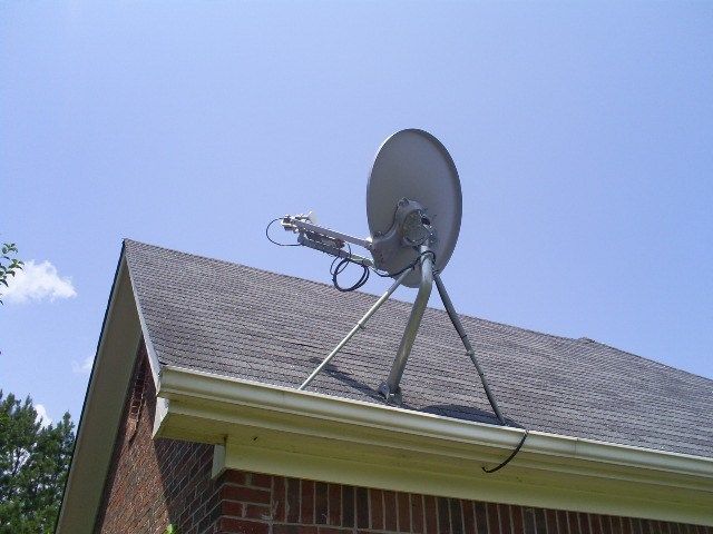

Wild blue is supposed to be grounded from the dish to the Radio with a #10. From there, they are calling the shielding the ground out to the block, but that's not NEC spec UNLESS they use quad sheild, and I've never seen quad shield on a WB. HNS does the same thing, but they almost always used quad shield around here.
Anywho, here is a picture of the "standard" HNS mount. WB has one, too. Furthermore, WB uses a funky sized pipe, so if you just get some universal tripod, you might catch hell finding the proper size pipe to fit it. HNS is standard 2 3/8 mount. Same thing channel master dishes and old primestar (because they mostly used channel master stuff) used.
