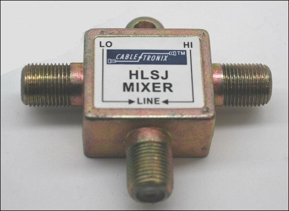

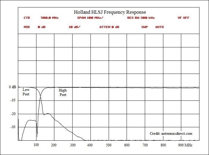

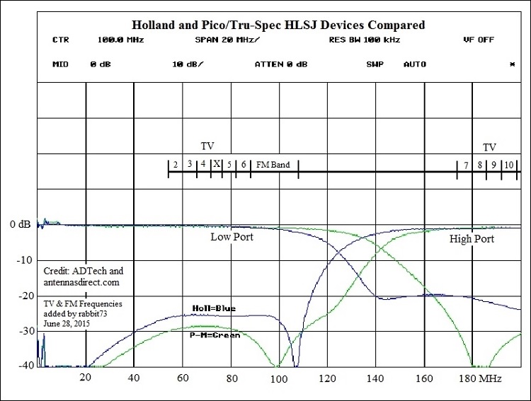

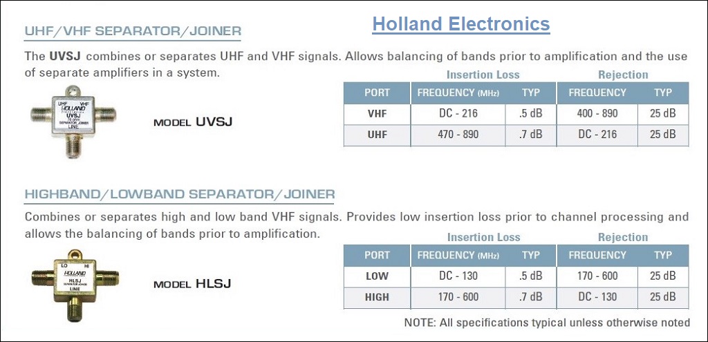

What you need is a HLSJ (VHF-High/VHF-Low Separator/Joiner), but they are getting hard to find.
The HIGH port will pass VHF-High and UHF:
A HLSJ is a type of diplexer. A UVSJ is also a type of diplexer.
