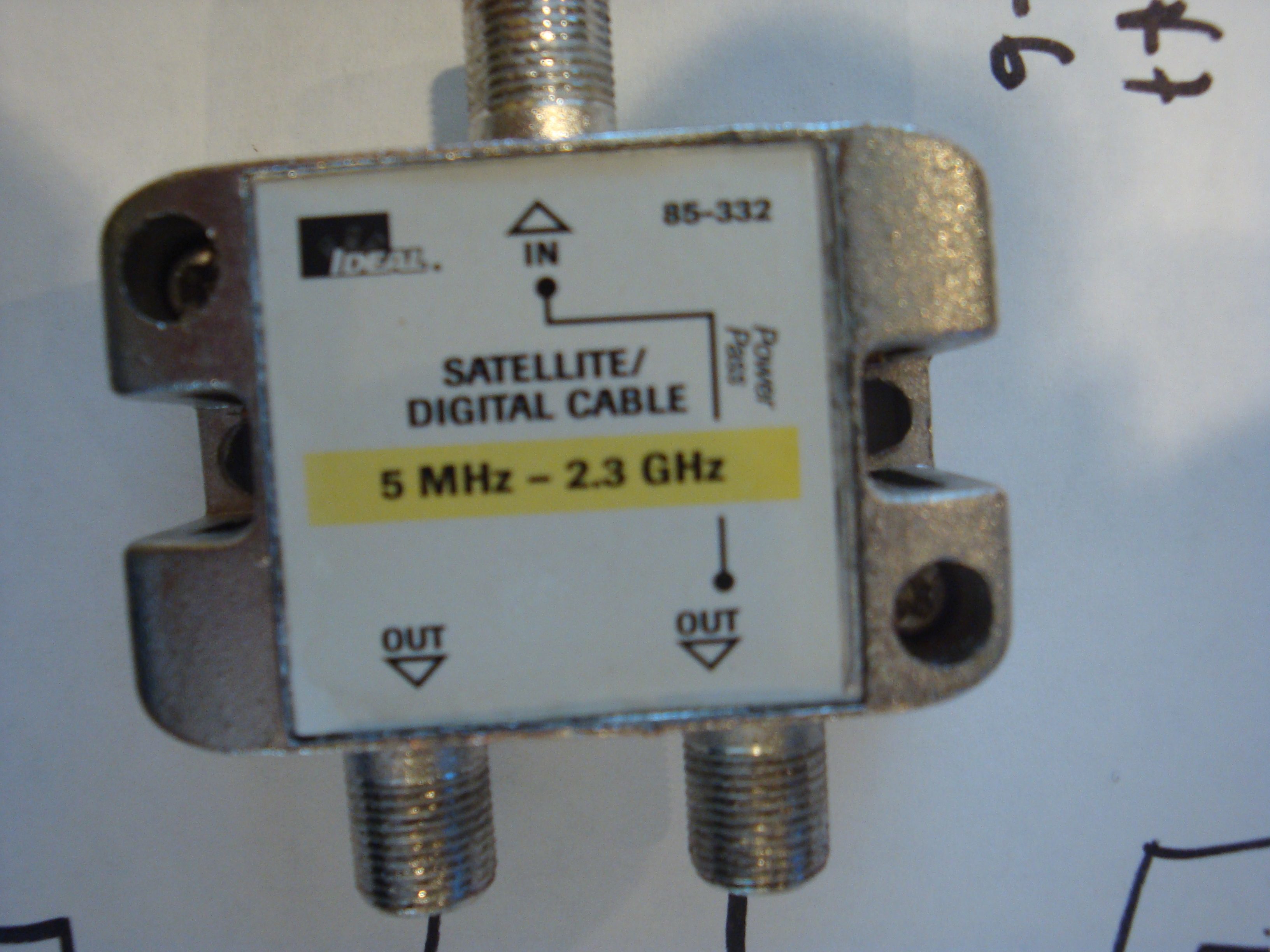

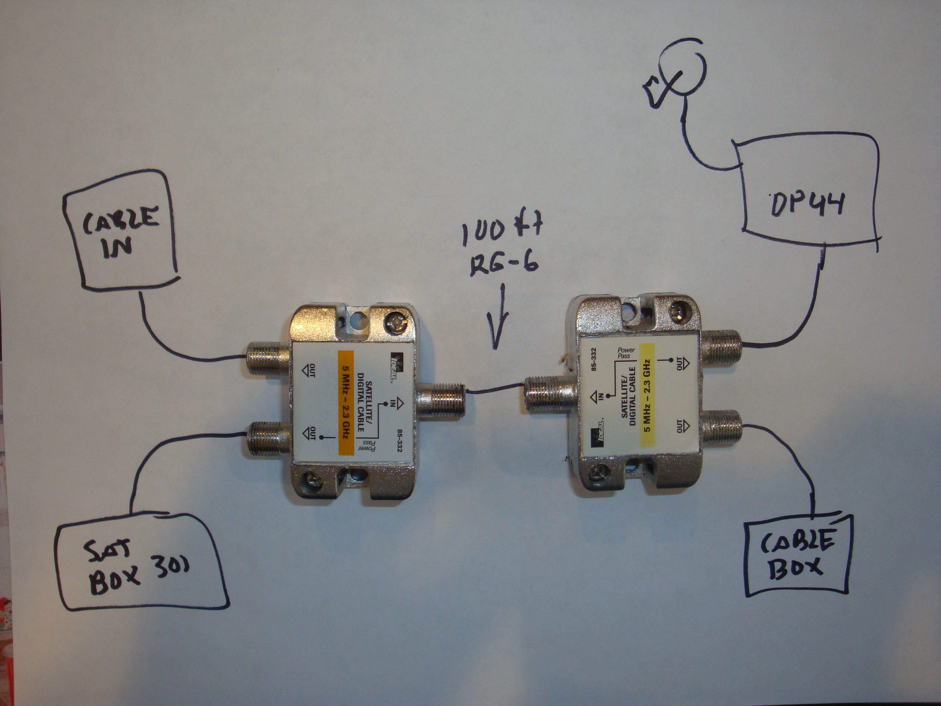

I don't know about Huges, but all last winter I shared one coax cable to get cable to my son's room in house and satellite feed to my office. Feed was two directions and separated with satellite/digital cable splitters I picked up from home depot. I don't use this setup anymore, but sharing one cable is possible with right splitters. Look pictures.
Aklarvanto,
The only reason this works is that your Cable Company does NOT use the same frequencies as the LNBF is sending. Basically the "Splitter" you mentioned is absolutely NOT a Splitter, it is a Diplexor. A Diplexor combines the Satellite Feed and Cable feed together, but must be used in pairs. You can use a Diplexor to combine the signals, but then a second Diplexor is used to separate the signals again when the signals are at their destination.
To summarize, the only way this works for cable/Satellite on a single cable is that the Cable company is NOT using the same frequencies the LNBF is using, as well as the Cable companies equipment is immune to the DC voltage your STB is providing back to the LNBF. This can not be said for a single cable Satellite Service /competing Satellite Service bundled on the same cable.
