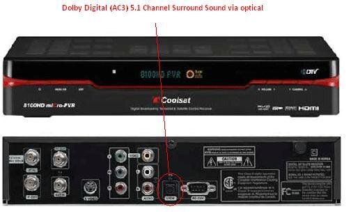

You mean your not hearing sound on AC3 Dolby Channels? The sound comes through the S/PDIF Optical connection on the back your Coolsat. See Attached Picture. It does not pass through the audio RCA connections.

To get the audio to pass through to your regular set up do a forum search in the FTA section about Sonic Voom Headphones. Many of us members has "Modified" them to work with conventional stereo equipment!
