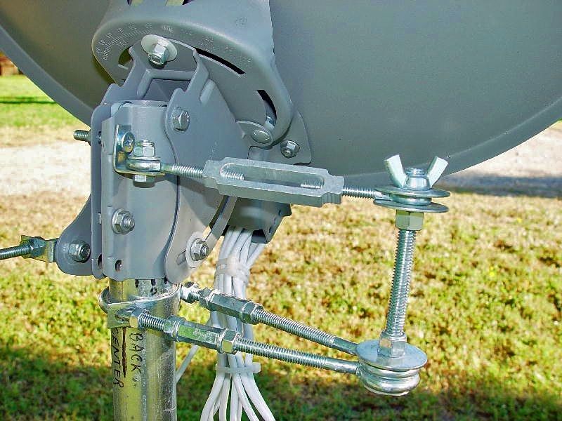

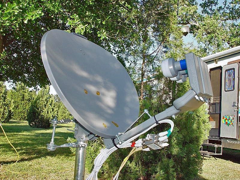

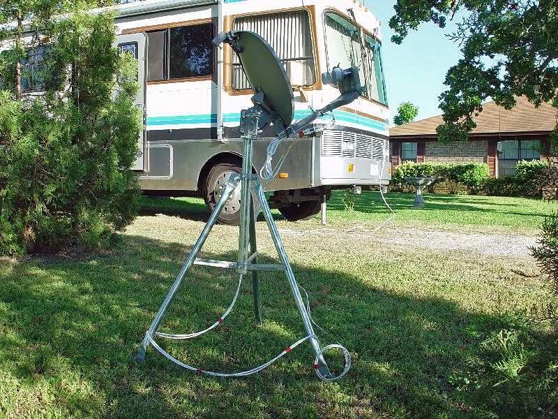

Here's some pictures of my tripod mount.
I found that constantly setting the thing up makes having some fine tuning adjustments desirable. A permanent location at a home only needs aiming once. But in an RV everyday needs new aiming when traveling.
So I made elevation & azimuth that I can adjust with turnbuckles. Also note the barn hinge on the arm. It has a screw adjust so that placing an inclinometer on it will read the elevation directly. Also note the reflector's bolts are epoxied on to make easier setup. And nylon washers to allow easier adjusting.
