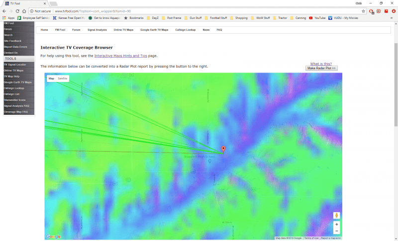

As you can maybe see on my coverage map below I do have a small rise in elevation as I move off my property to the west toward the towers. But I'm pretty sure I am peeking over this elevation with just a 20 or 25' antenna elevation.
I think the main ridge I'm probably dealing with is the bright green that starts just over a mile away.... When I show a 50' tower on the other station map I get a couple towers that become LOS.
