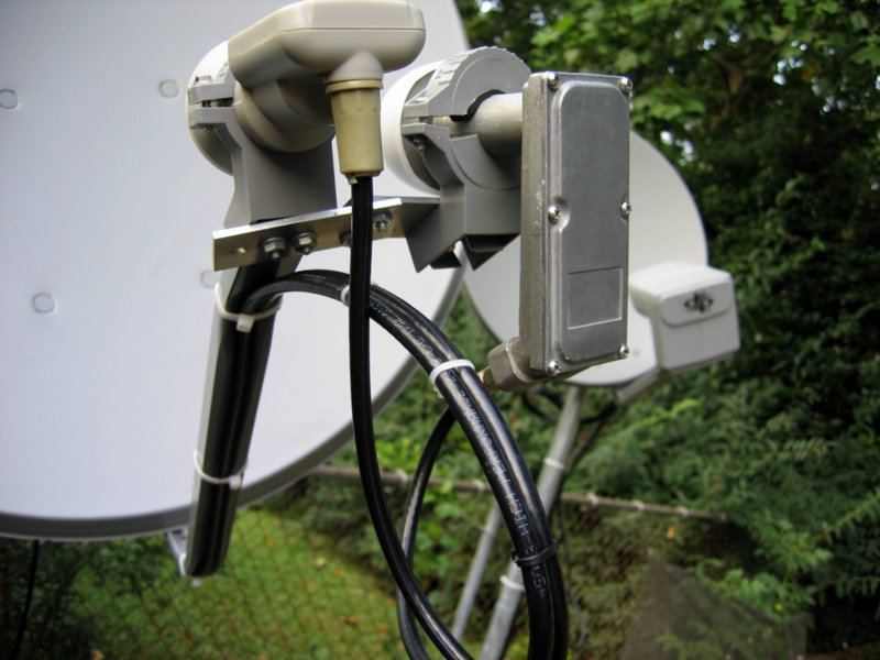

When I installed my dbs LNB to the side of my ku LNB I didnt even try to get it too close, just line it up as close as you can to the same level and focal position as close as you can then motor left and right and you will hit the dbs satellites, they are very strong and they just bounce right into the DBS LNB, not very scientific but it will work, the problem is getting the dish/motor to remember the position, but I use two receivers and just motor round until you hit the dbs satellite/freq. I want!

That's exactly what I did, I get 100% on almost every TP.
"Very" neat work! I like the dual cable idea.
I am working on a "double dish" and you would not need to use the above method any more, you motor to say 101w and you will be able to see DirecTV 101 and AMC4 at the same time (you use a Diseqc switch to choose), no more having to take the off set into account, Its still in the design process right now, but Iceberg has seen it.
I forget where i got those sweet twin cables from ;)
The bracket is a bodge but it's solid and works for now.

I am very much in need of a mount / bracket to hold a LNB , maybe like one or the other of the ones in your picture ( can not tell for sure ) .
Can you tell me where I might find brackets , mounts ?
The used dish 90 cm came w/o a bracket / mount . The " arm " is rectangular and fits a DTV lnb perfictly , but I want to mount a linear LNB .
Also , the receiver I want to use it with seems to only have a place in the setup menu for a single LOF ( standard LNB ? ) . Are " standard " LNB's avalable ( I have a universal ) , or is that a thing of the past ?

I assume the right LNB is a DIsh one, but how did you get it to hold?
I moved my 30" dish that I was using for G10 over to Nimiq1 for my ExpressVu setup, and I gutted the top part of the LNB case for the Dish LNB, but it was too small to hold right in the clamp....
I ended up wrapping duct tape around it for now...how did you get it to hold?
My dish came with a spare LNB holder which was slightly too narrow for the throat of the LNB so I took some plastic out of the spacer ring and used a rubber foot off an Xbox to pad it (You can see it over the top of the LNB throat, the black strippy thing) and it's solid.
Any strip of rubber will do the job, I just had a few lying around from people who had trashed their Xboxes by trying to mod them.
