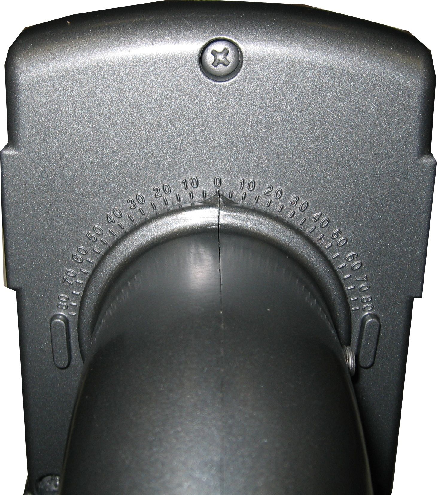

I have a DG380 and FortecStar 1.2 meter combo that I purchased a few weeks ago. I've gotten it aligned and tracking the arch correctly but I'm having a problem with east and west movement of the dish.
The motor is able to move the dish 50 degrees from my true south and still come back (any further than that and it needs to be "helped" to go east again). My real problem is that I can only go 20 degrees to the east before the dish needs to be helped to go back to the west.

The screw you will need to replace is the bottom one on the following picture:
A batch of motors were shipped with wrong screw (the one on the left and the black one)
The correct screw is the one in the middle of this picture:
The correct middle screw measures 22.53 mm

Yes, you could remove the motor cover without even taking the motor off the pole or dish.
If you can reach the 3 cover screws located at the bottom of the motor,
unscrew it.
Take cover off.
Remove suspect screw
Measure it. If it is more than 22.53 mm or colored black, then you have a bad screw.
let us know and we will mail you the right screw.
