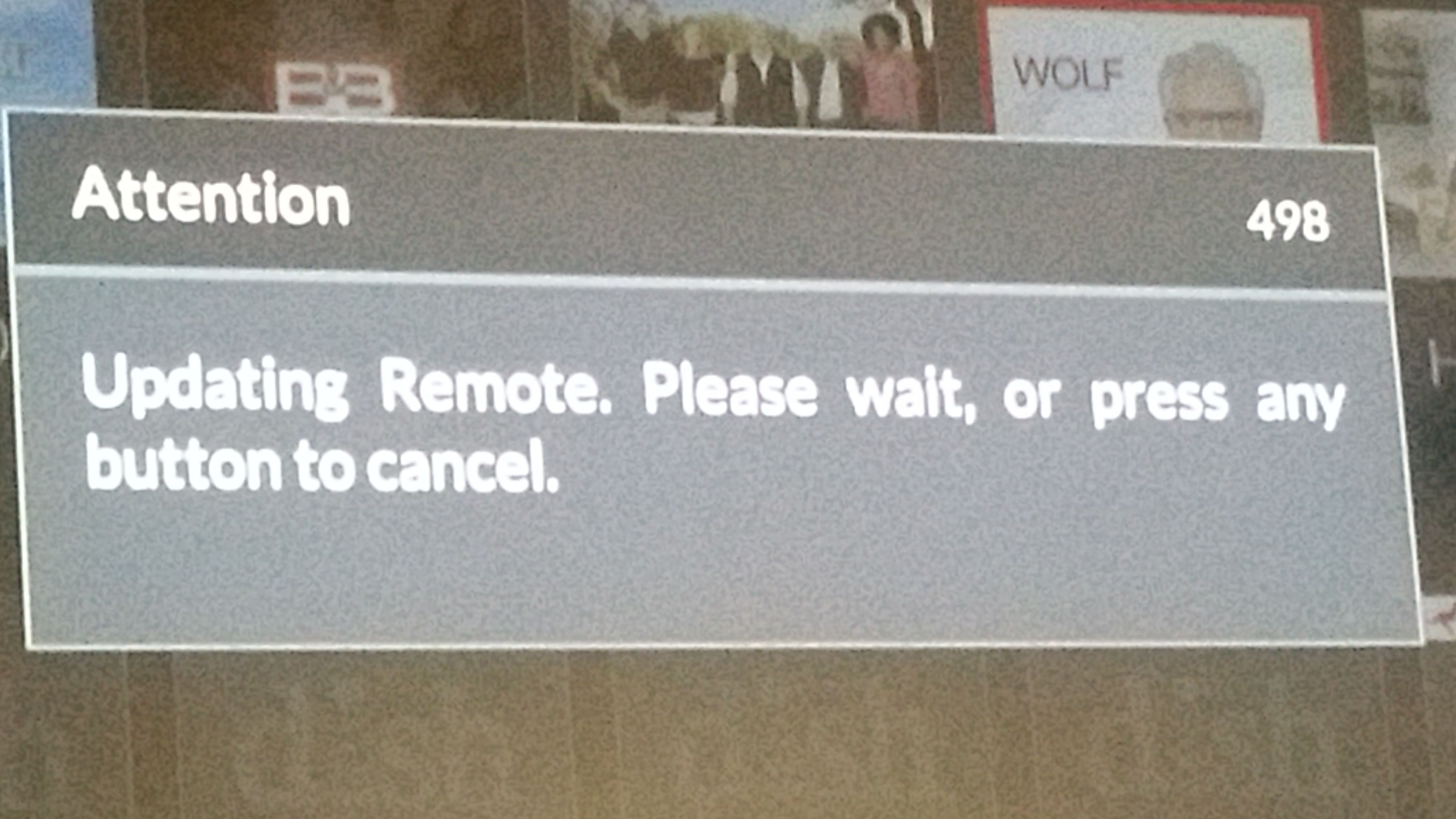

I thought you were nuts for I never saw or heard this ever... 3 minutes later I see this on my screen.
White circle with right pointer (?) in EPG.
