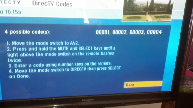

How many possible codes for a DirecTv d12-500? I have 3 d12's in one closet. I have only been able to get one to work in normal mode on one code and one in (AV1 or AV2) mode.
Been a long time since I used a D12, but I know some of the receivers have an advanced setup menu in the remote control setup. In there is options for up to 8 different IR codes. This is a common need for sports bar type environments.
I've done it many times.
Are you sure all 4 actually work on a D12? Last time I checked, only 1 and 2 did (LINK). Your screen shot looks like it's from an HD receiver (H21 maybe?), not a D12.
That's NOT an HD receiver. Still has the blue and yellow menus. It's for sure an SD box
They have had that screen in the menu under programming the remote for 8 years. Never meant anything when it comes to programming the receiver for alternate codesets. The D12 only has two, 00001 & 00002.
