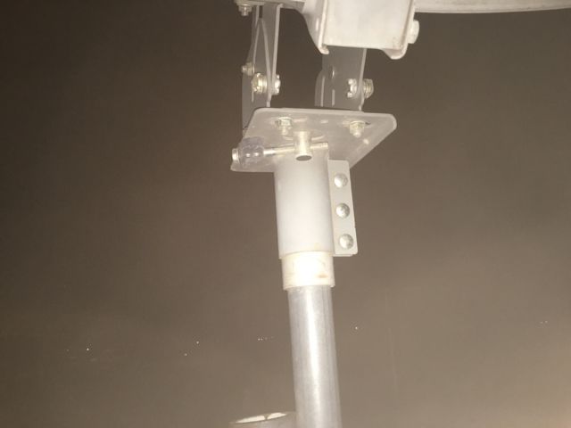

You could use 1/25" sch 80 pvc as an adapter. It's 1.25" id and 1.66 od. Then use the adapter sleeve to go to 2".
Here's a pic
