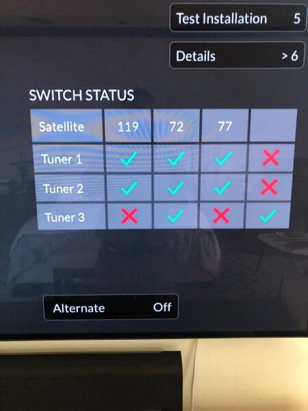

Hopper with Sling with DPP44/solo node and sat 72,77 and 119 is doing a check switch every morning and I am getting the following results from check switch. Anyway to fix this?

Very rarely, I have gotten weird results like that from Check Switch on my Wally on Western Arc. To fix it, I unplug the power inserter for the DPP44 switch, run Check Switch on the receiver to clear out all of the satellites, plug the power inserter back in, and run Check Switch again.
