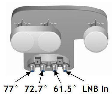

hi i live in blaine WA near seattle. just got my 1000.4 dish and i have vip 211 reciever. i been trying to install it for 3 days and keep getting problems.even though i am in west i went to dishpointer and according to them i should be pointing to 61.5,72,77. when i first got a signal i was using port 1 and i got about 60 strength signal of 61.5 so i did a check swith without having reception for other sattlites. Now the problem is i only get signal for 61.5 which is strong, i also get 72 at about 30-35 but unable to get 77. whats weird is when i check switch it shows 61.5 on port 1 and 72 at port 3 but when i try to block the lnb with tin foil i am actually getting the 61.5 in the middle lnb and 72 on the first lnb. i tried using covering the outside lnb's with tin foil and plug in the second port but get no signal at all.
i dont know what is going on can somone please help me
i got wa lnb assembly i ordered it from ebay and it said western arc. how can you tell differnece between the two? im pretty sure its wa. i dunno why dishpointer would give me settings for the 61,72,77

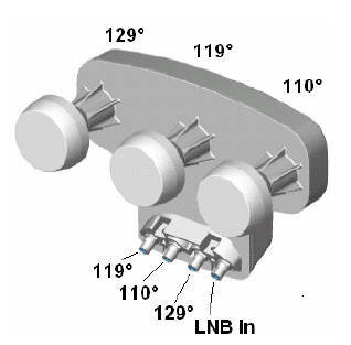

The Western Arc LNB's "eyes" are (almost) evenly spaced. The Eastern arc LNB has 2 next to each other, and one away from them. Use the settings for a 1000.2 on dishpointer.com if you are sure you have the WA LNB. The first one here is the EA LNB, second is WA
i pointed towards 119 west using port 1 and right away i got signal for all three sattlites. getting a relly good signal around 70 everything worked out well. thanks so much. saved me 150 installation fees. cheers
