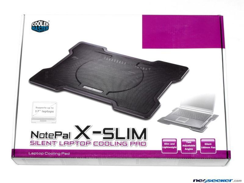

thanks for the help guys I bought a Cooler Master Notepal X-Slim Notebook and the hopper hasn't rebooted.
I guess it was overheating
HDD High Temp 114F
HDD low Temp 84F
HDD Average temp 107F
